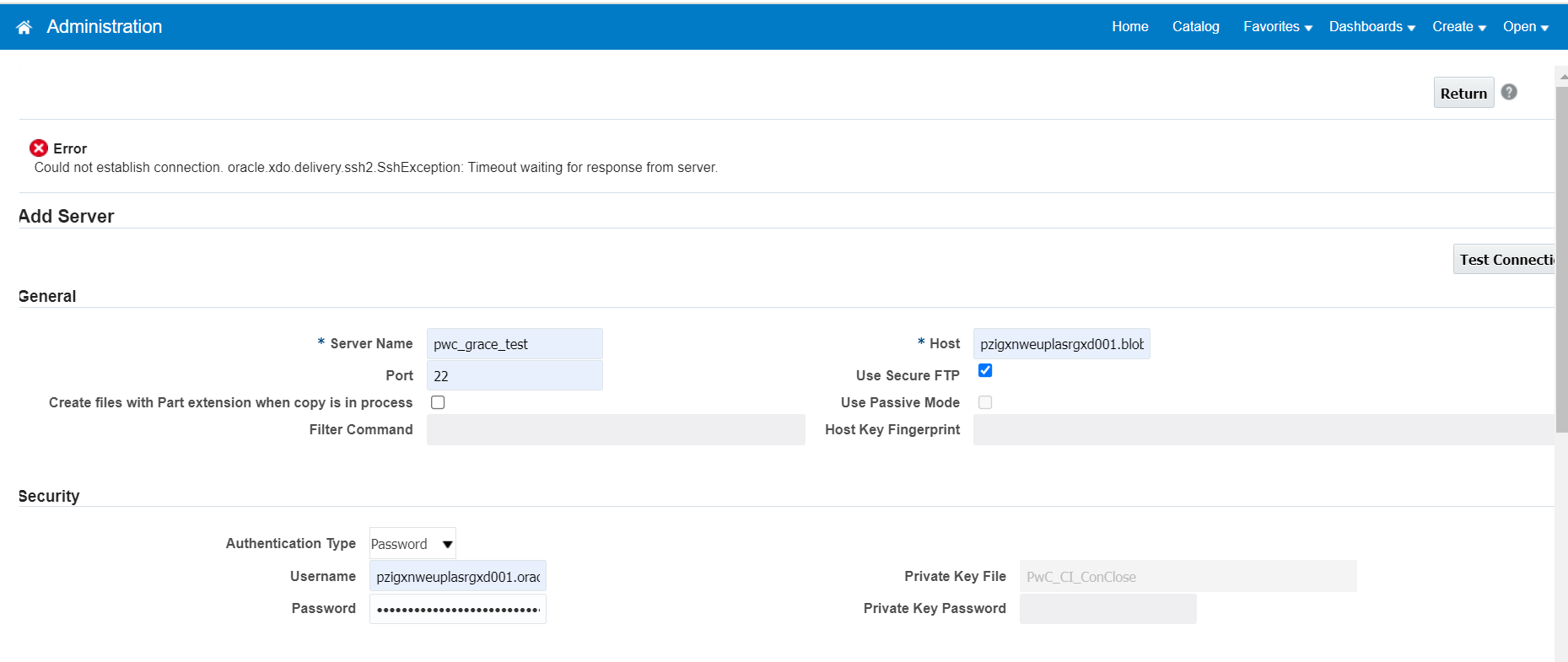

I am getting below error while trying to create new SFTP connection to connect to MS Azure Storage SFTP from Oracle fusion BI publisher administration.
Error: Could not establish connection. oracle.xdo.delivery.ssh2.SshException: Timeout waiting for response from server.
I am able to connect to this server from WinSCP with no issues.
FYI, Created SR# 3-29253091671 (is closed now) and 3-29999166351 in the past for issue related to Microsoft Azure SFTP and Oracle fusion BI Publisher connectivity.

Hi,
were you able to solve it?
I'm getting the same error and I've been told the PK algorithm (ssh-rsa) is not supported by azure storage sftp.
It seems azure sftp supports ssh-rsa for public key but not for the host key (which is I guess what is required).
