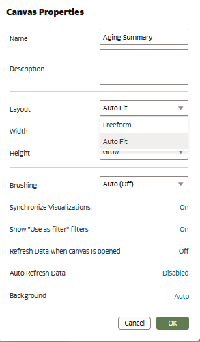

In OAC go to Canvas Properties and instead of using Layout = Autofit. Try using Freeform. You have more flexibility when staging visualizations on the dashboards.
