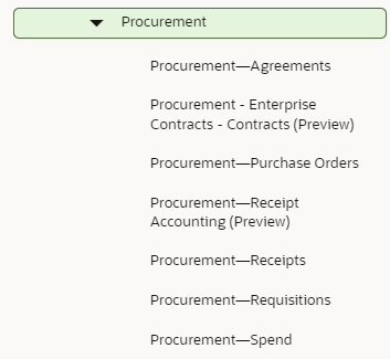

If somebody enables Procurement from Fusion ERP side and we enable it from FAW SCM side (not FAW ERP), will procurement subject areas work?
Hi @Victor H
No. Some of the SA are preview & have an dependency on different modules.
https://docs.oracle.com/en/cloud/saas/analytics/24r1/fascm/chapter-subject-areas.html#GUID-214EAA9F-D523-4C15-93FF-49D047147E75
For more details -
https://docs.oracle.com/en/cloud/saas/analytics/24r1/fascm/chapter-subject-areas.html#GUID-9898C12A-CA24-475C-9811-1371A4A9478F
Always Refer the Data Lineage Document for Subject Area's Based on your Fusion Source.
For example in our case its' an SCM -
https://docs.oracle.com/en/cloud/saas/analytics/24r1/fascm/chapter-data-lineage.html#GUID-1E0A8BAA-568F-4DA0-A91A-C867F787C29D
Data Lineage Spreadsheet
Regards,
Arjun
