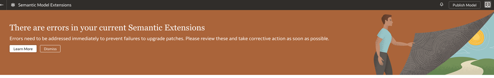

Customer’s might see below notification banner in SME tile - this message banner is a proactive notfication to inform customers of any missing columns which are used in SME which should be reviewed and corrected. This message should not have any SME/user impact.

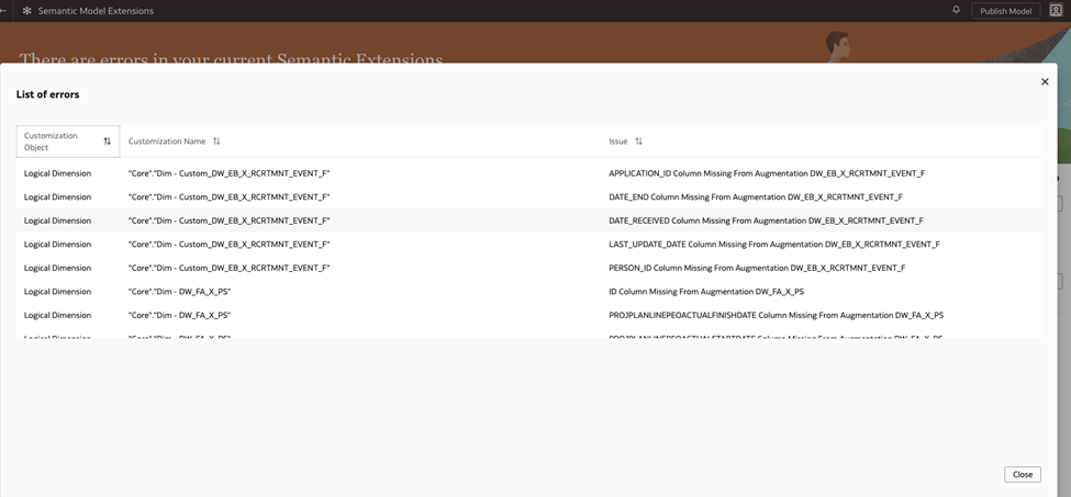

Please click Learn More on the Banner Message to get error details as following: this message will continue to appear untill all objects/columns/sme listed are reviewed and updated/fixed.
For example In this test instance we can see following warning/errors:
Above error/warning messages are generally to notify that there are some columns which don’t exists but are used in SME steps and should be corrected as soon as possible.
Scenario 1: These warning/errors should not cause any functional impact on the FAW application. Please go through each error message and validate the columns if they exist as shown in following validation example –
PERSON_ID Column Missing From Augmentation DW_EB_X_RCRTMNT_EVENT_F |

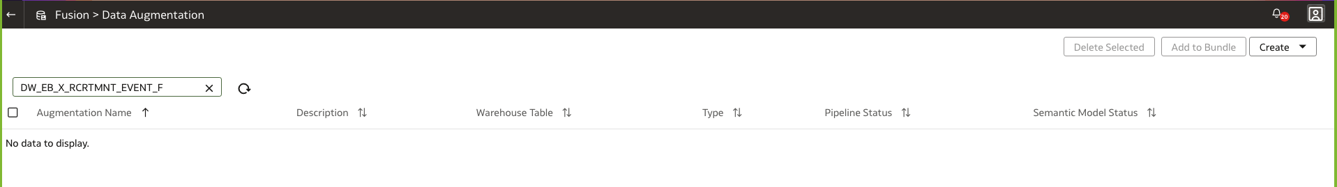

Next as per above error we can go and check Augmentation DW_EB_X_RCRTMNT_EVENT_F
As we can see in following this augmentation doesn’t exists and needs to be removed from "Core"."Dim - Custom_DW_EB_X_RCRTMNT_EVENT_F"
All Scenario 1 errors should be reviewed fixed by customers.

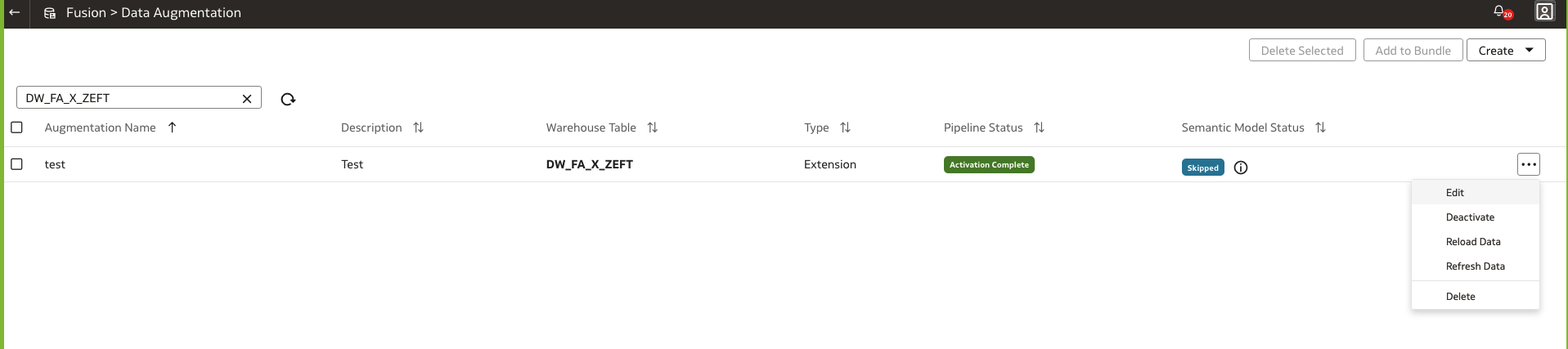

Next we go and check the augmentation for the above message.
We can see the above augmentation exists. To check the column, we will edit the augmentation:

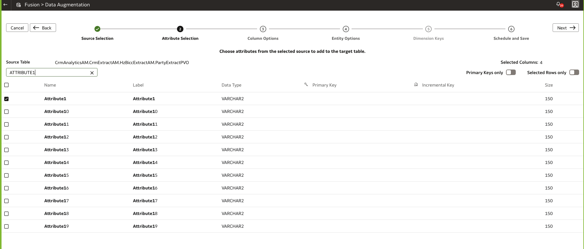

We can see ATTRIBUTE1 Column is available in Augmentation DW_FA_X_ZEFT
If you find that the column does exists in Data Augmentation and the particular warning needs support review then please raise a support SR with all the details for valid column pasted in a word document so that support can validate and guide on next steps.
