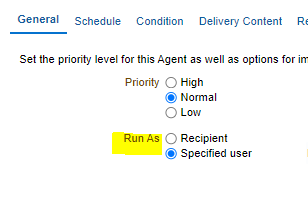

    Was it exactly the same query SQL? With exactly the same parameters? Executed as exactly the same user with the same roles and data access setup? Remember that when you create an agent you have the option for it to run as the user who created the agent at design time or as the user who executes it at runtime. Who is the agent running as?

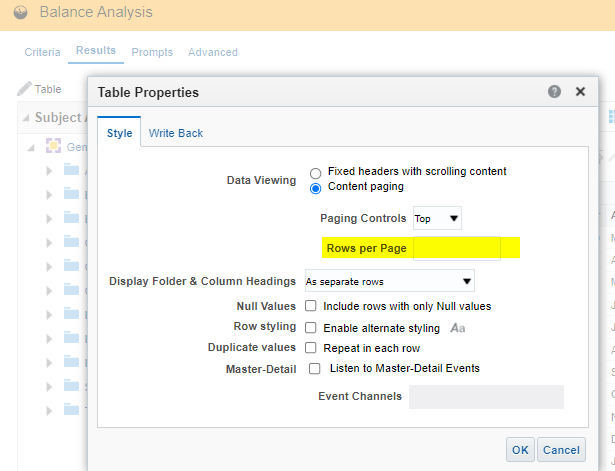

    Question….when I run the analysis manually, there are several pages of data. Does something need to be tweaked on the agent job so that it will export all pages of data? Could that be why some data is getting dropped?

    Question….when I run the analysis manually with my ID, there are a few pages worth of data. Do we need to do something to the agent so it will export all pages of data? Could that be why some records are missing?

    So an important setting on the agent is whether the agent instance "Run as" you the "recipient" user at runtime or always the same user as "specified user" setup at design time? When you run it manually then it is your signed in user at runtime obviously.
    If you are using the default view "table" then the number of rows per page is set here so the number of "pages" you get is up to you up to maximum setup by in system by default 500 (no pages)
