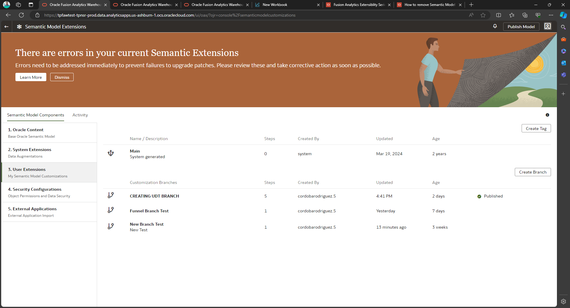

I get these errors in semantic models afer I removed a data augmentation, how can I fix it?

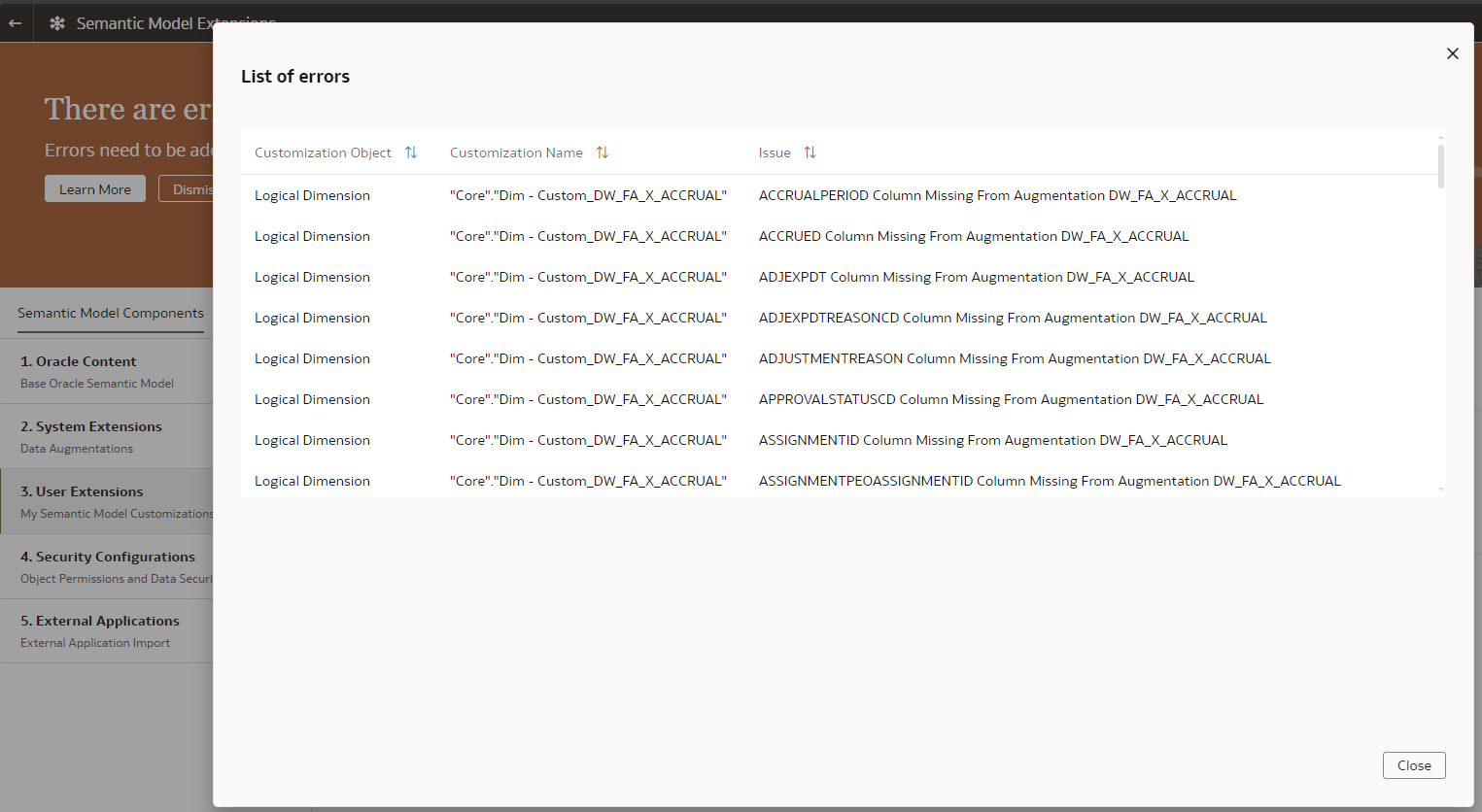

    Thank you @Mallikarjuna Kuppauru-Oracle however this Data Augmentation was not use in any of the semantic model extensions that I have, how can I locate where is the issue coming from?

    As per Error message, Below is the Logical Dimension is showing the Missing Columns -
    DW_FA_X_ACCRUAL
    Can you confirm are you getting this Error while clicking on User Extensions? then you have some reference .

    That is correct, I'm getting the error on user extensions, but I just have three customizations and none of them involve that Data Augmentation

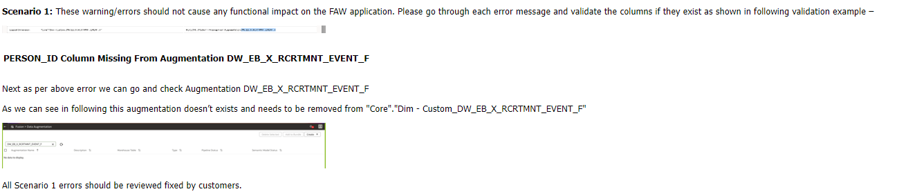

    Can you check do you have any Extended Dimension steps on customization related to above Logical Dim.
    Refer - FAW:FDI:FDIP: SME Warning/Errors Banner Notification - There Are Errors In Your current Semantic Extensions (Doc ID 3020134.1)
    Regards,
    Arjun

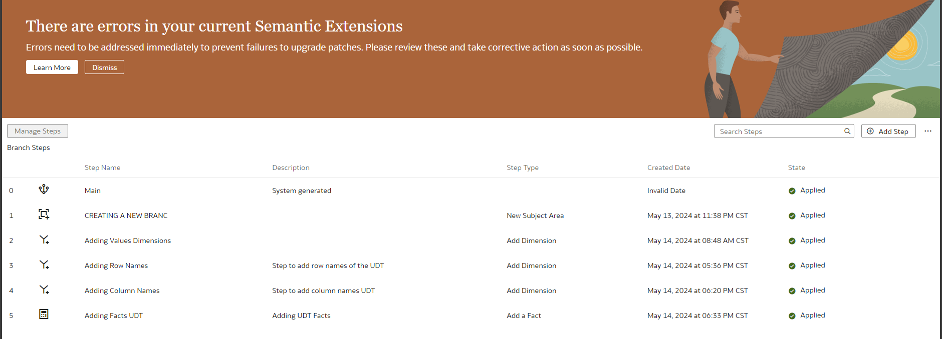

    I dont have extended dimension steps related to that Logical Dim, these are the only extended dimensions that I have and all of them are working fine because they are related to other logical dims
