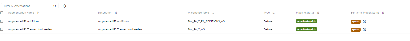

I wanted to bring in the unaccounted FA transactions, so I was testing out data augmentation using dataset. After having created these datasets , what are the next steps to model these semantically and use in reports?
@User_L2TQS - You need to extend the semantic model using SME to bring in the customisations. Please refer the below document for more details:
https://docs.oracle.com/en/cloud/saas/analytics/24r2/fawag/recommendations-and-tips-extend-semantic-model.html
