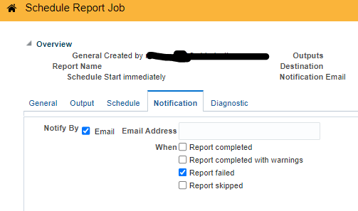

The request is to receive an email notification if the OTBI Job is failed. I know the option is available for BIP but how can I accomplish that for OTBI?

    Hi, Yes that is correct.

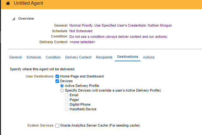

    Yes when you schedule a report in OTBI with a "Report Job" in OTBI you do have an option to send an notification by email on failure.
    But no when you schedule an analysis or dashboard page or briefing book in OTBI with an "Agent" (intelligence robot) in OTBI you do NOT have such an option for a notification on failure. The status and error messages from failures do get stored in the configured Siebel eNQuire bi scheduler database repository schema tables S_NQ_JOB/INSTANCE/JOB_PARAM/ERR_MSG. But I do not think our host has allowed for us to query these 4 tables like we can the 2 usage tracking S_NQ_ACCT/S_NQ_DB_ACCT tables using our connections out of the box in OTBI in SaaS. BTW If an agent fails too many times you get to know because it gets disabled.
