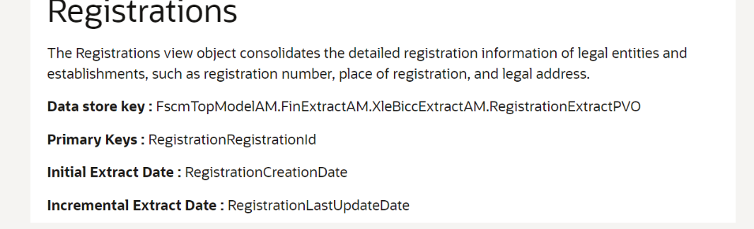

I've been struggling to add the registration number in FDI.
How can I join this table with either the hierarchy org folder or the common folder please ? What are the primary keys that can be used ? Is is straight forward ?

@Lauriane Massin Whitaker Can you try the Entity Keys suggested below ie. Organization_ID
Entity Name
Domain Code
Entity Keys
Table Name
Table Column
Organization
PER_ORGANIZATION_UNIT
EFFECTIVE_END_DATE
DW_INTERNAL_ORG_D
EFFECTIVE_START_DATE
ORGANIZATION_ID
Data Augmentation Spreadsheet
Use this spreadsheet that contains Entities and Entity ID mapping details for HCM. Select "Entity" in the Data Augmentation flow.
https://docs.oracle.com/en/cloud/saas/analytics/24r4/fahia/chapter-data-augmentation.html
@Lauriane Massin Whitaker Can you please let us know if you are trying to Add this PVO based Augmentation table as Add Dimension or trying to extend an existing dimension? Also, which particular Subject Area folder are you trying to use here to inculcate this change?
I'm trying to extend an existing dimension. I'd like to add this registration number in the Hierarchies subject area, in the Organization Hierarchy folder in Workforce Core.
