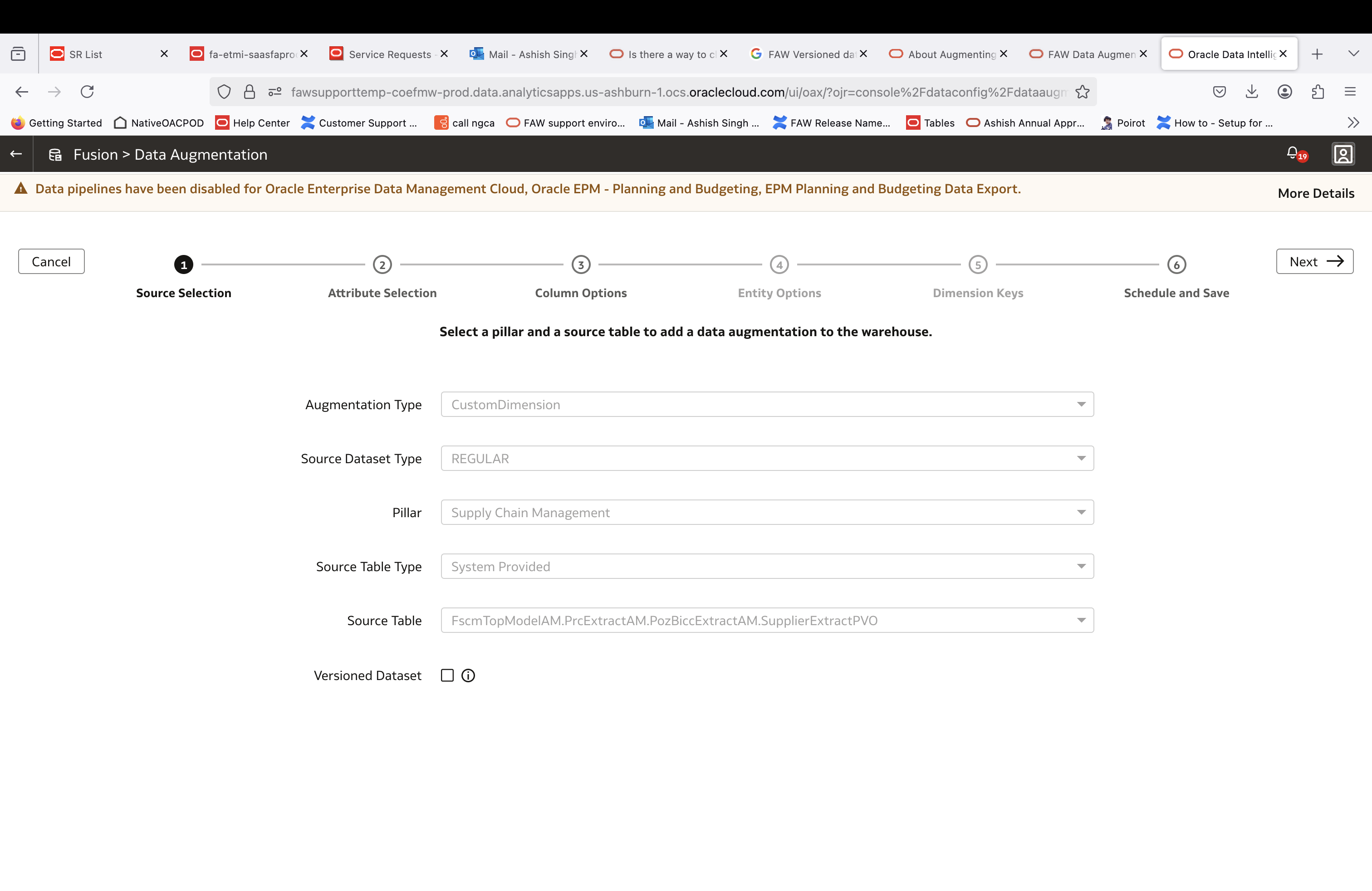

Is there a way to clear out a database table for one of our data augmentations before running the daily pipeline load?
We have a need to load in brand new data every day and we do not want to retain any cumulative records.
@Kevin Riedy The Versioned Dataset feature enables to run the corresponding Data Augmentation pipeline as a full load every time. This means the data in the target table will be truncated and reloaded every time.
https://docs.oracle.com/en/cloud/saas/analytics/25r1/fawag/augmenting-your-data.html#GUID-CE523E90-A30C-45B0-880B-6EC338E38B32
Hi @Ashish-Oracle that was exactly what I was looking for. Thank you for the speedy response!
