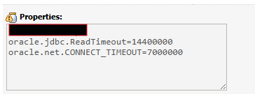

The DataSource i created in XMLPSERVER that have no any properties for me to do tuning or add parameter.
So i Create DataSource in WebLogic with oracle.jdbc.ReadTimeout parameter and set 4hour.
Created JNDI connection from XMLPSERVEFR and link to WebLogic DataSource.
Report DataModel choose this new JNDI DataSource, so the report able trigger more than an hour and within 4hour timeout it able to finish.
