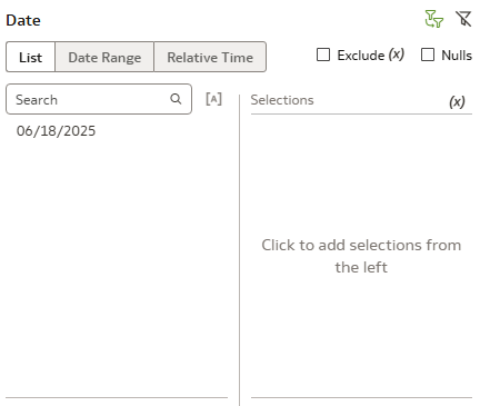

By default, in our headcount report, we are only able to see current date in the date filter. How can we modify change this so users can filter for headcount on a specified date.

    Jennifer Nakata Rank 2 - Community Beginner
    Answer ✓
    I also experienced this challenge .. the only solution I found was to click the green filter box in the upper right hand corner, and select "None". This opened the selection options.

  • Jae.L
    Jae.L Rank 4 - Community Specialist
    @Jennifer Nakata thanks, this worked.
