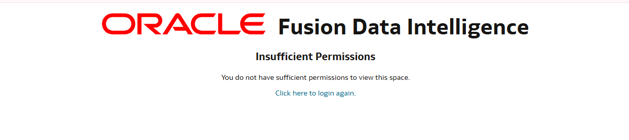

Hi,
What might cause some users to receive an “Insufficient permissions” error when signing in to our SSO‑enabled FDI instance provisioned from Fusion?

Hi @Sawrub
welcome to FDI community.
As per Error, its an permission Issue -
Check your fusion application and see you have enabled the IDCS sync. take one user and see the permission/roles assigned to user to debug further. most of the time its an issue with roles assignment Only.
https://docs.oracle.com/en-us/iaas/analytics-for-applications/doc/set-user-access-oracle-fusion-data-intelligence-using-single-sign.html#GUID-8E6311FF-C26F-4BA2-B48F-AFDC150051CE
Refer some of the know KM's.
FDI: Error 'Insufficient Permissions' Occurs When Attempting User Access to Console Page (Doc ID 3007779.1)
Let me know if you have any further questions?

I'm getting the same error. I was able to login until 24 hours ago. IDCS has been synced. Otehr users are able to login too
