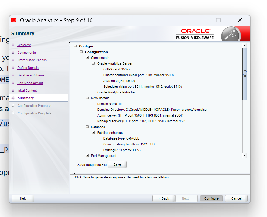

Hi ,I was trying to configure OAS but it is stuck at configure button .Button is greyed out.Please help on this

Start from the beginning: what version are you installing? On what kind of environment? Is your environment certified? Did you check the log files?

Trying to install oa_platform-5.5.0.0.0-20200829051051-win64,fmw_12.2.1.4.0_infrastructure in windows 11

Make sure to apply the required Stack Bundle Patches before configuring OAS, and follow the installation instructions. This will help avoid many issues.
Preparing to Install and Configure Oracle Analytics Server
https://docs.oracle.com/en/middleware/bi/analytics-server/install-config-oas/preparing-install-and-configure-product.html#GUID-16F78BFD-4095-45EE-9C3B-DB49AD5CBAAD
You can stop directly, that isn't a certified environment…
https://docs.oracle.com/en/middleware/bi/analytics-server/administer-oas/certification-systems.html#GUID-BD72F48C-3DF8-4B9E-81AB-23164B497AB4
You are trying to install an enterprise analytical platform on a desktop OS, this is not supported. Also, OAS 5.5 is 5 years old, not supported anymore for the past 3 years.
Look the link above, make sure your environment is supported before to try to install OAS. There is a countless number of threads of people who really tried very hard to install on Windows 10 and 11, with no success.
If you are installing on your laptop/desktop, use a virtual machine to provide a supported OS first. Or docker will also work. WSL2 images I didn't try, but has chances to work if you start from a supported OS image.
