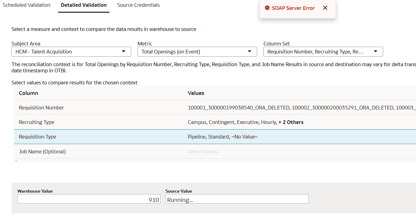

I'm doing data validation in FDI , and found that I'm getting SOAP server error for HCM - Talent Acquisition related metrics.
and I'm getting SRC value null for HCM - Workforce Absence Management related metrics (instead of soap error)
What does it mean , how Can i give access to these 2 subject areas to my user in Fusion ?

    @Sumanth Nimmagadda - Welcome to the Oracle Analytics Community!
    Please ensure that all subject areas to be validated are activated in OTBI.
    For reference:
    FAW:FDI:FDIP: Data Validation Does Not Retrieve Source Value and Displays 'SOAP Error' [Video Content]
    (Doc ID 2932101.1)
    Please check with a user who has OTBI Administrator access to confirm that these Subject Areas are accessible.
    For values showing as null, refer to the following video, which demonstrates the troubleshooting steps:
    Ensure Data Accuracy: Using Oracle Fusion Data Intelligence Validation Capabilities
    Keep engaging with the Oracle Analytics Community — your questions and participation help everyone learn and grow together!
    • Can you try using SOAP UI or Postman with the user credentials.
    • If you get 401/403 — it’s a privileges issue.
      If you get a 500 SOAP error — the web service might be disabled or under maintenance.
