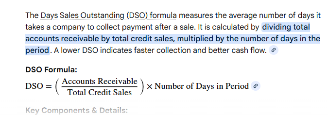

I would like to develop FDI table visualization that has DSO using 12 months and Rolling 12 months Revenue using Fiscal Period. Relative time function is not available for Fiscal period. How to calculate DSO and 12 months revenue.

Yes, I used trailing period number using filter from 0-11. what are corresponding fields from AR Revenue and Transactions to calculate DSO. Please refer if I need to use any other subject area.

@Rupali V in either AR Balance or AR Aging there is an Original Amount field. You could try that.
