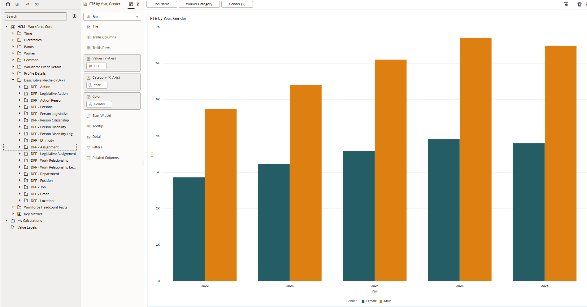

I am trying to create a workbook using the subject area 'HCM - Workforce Core'. Attached the one I created. , but I have to filter it with some salary code(lonkode). ( We already have the same report available in Qlik and I am trying to recreate it in OAC), but I don't see any HCM related subject area is having this lonkode value. Please suggest how I can rectify it.
Regards,

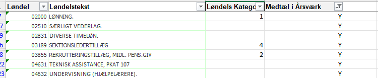

Thanks for your quick reply and I checked the above, but unfortunately it is not the one I was expecting. Its having the below sample values(Any of the 1st 2 columns).
Please let me know how I can get it in any HCM related subject areas?

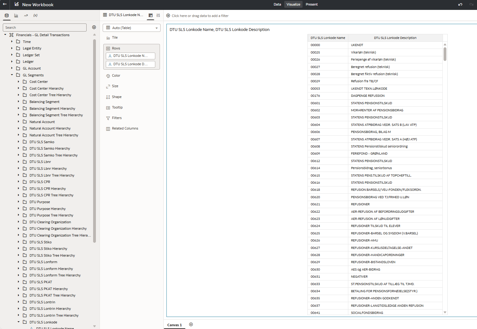

I could find these values under GL Detail Transaction LSA.
, but connecting HCM and GL transactions subject area is not an easy task. Is there any way we can get these components in HCM related subject areas?
