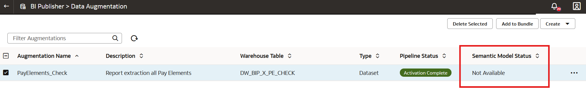

Hi, is it correct that after performing data augmentation with a report from BI Publisher, the augmentation has the "Semantic Model Status" set to "Not Available"? And if it needs to be set to "Available", how can this be done?
@Han Xi Zhao - Welcome to the Oracle Analytics Community!
Please note that the Semantic Model is not available for the Augmentation Type “Dataset”, and this is expected behavior by design. The Semantic Model is only applicable for augmentation types such as Dimension, Fact, and Entity Extension.
Additionally:
Reference - https://docs.oracle.com/en/cloud/saas/analytics/26r1/fawag/augment-your-data.html
@Ross Geddes - By using semantic model extensions. Please refer the below document for full details -
https://docs.oracle.com/en/cloud/saas/analytics/26r1/fawag/semantic-model-customization.html
Hi @Sumanth V -Oracle
Given the above, how do we make the data brought in from the BIP connector available to use in reports?
