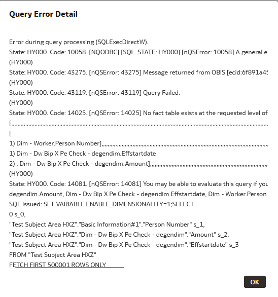

i am getting these errors when using a custom subject area
Hi @Han Xi Zhao
I think you need to have a fact within the subject area as this holds all the dimensions together. Try bringing the fact from your logical star into the subject area to see if this works. If that doesn't work, check the joins in your logical star to make sure that the detail in the fact can be reported at all these levels.
