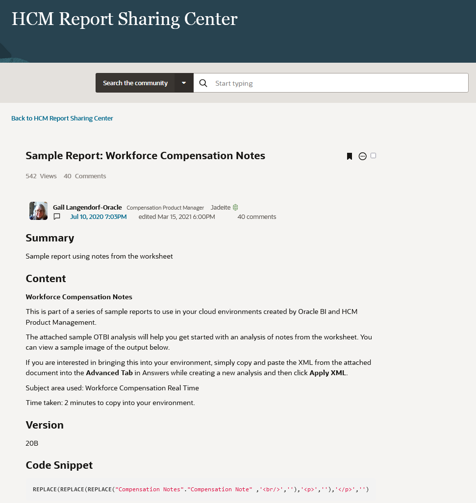

I posted a sample report that removes HTML tags, not for the same subject area, but the concept will be the same. See the code snippet on the post, it is a bit of a chore to figure out all the tags and list them all. In the code snippet I've removed the <br>, <p> and </p>. It's located here.
https://cloudcustomerconnect.oracle.com/posts/818b572b1d0 -

Review the Code Snippet in the link I provided.

REPLACE(REPLACE(REPLACE("Compensation Notes"."Compensation Note" ,'<br/>',''),'<p>',''),'</p>','')You have 3 choices. You can use a formula like above. You can use column properties. If you use plain text, then html tags will appear. If you use html, then tags will go away.
