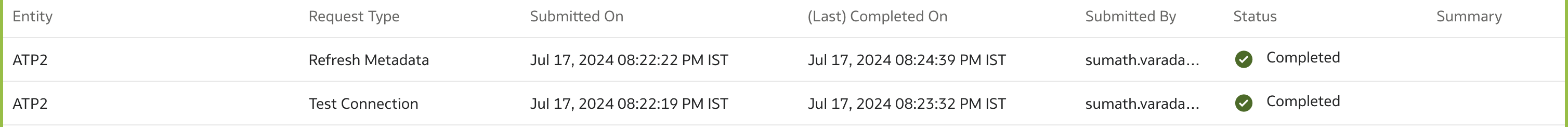

@ShyamKumarTech06 - Please let us know when this FDI was provisioned and what is the current version you are on. I tested in the newly provisioned FDI and it works.
0 -
@ShyamKumarTech06 As pointed out by @Sumanth V -Oracle this works as expected and looks like a environment specific ADW Connector issue . I would advise you to log a SR for this and have this further investigated.
