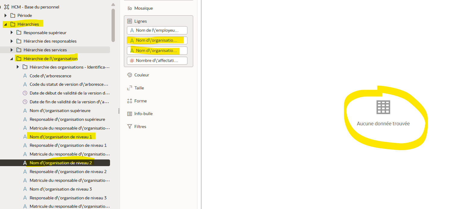

            Hi,
Last December, my client added another legal employer in HCM. I've checked the hierachial tree, and this legal employer has a service, business unit, and pole attached.
However, when I tried to find this legal employer in FDI, I faced an issue :

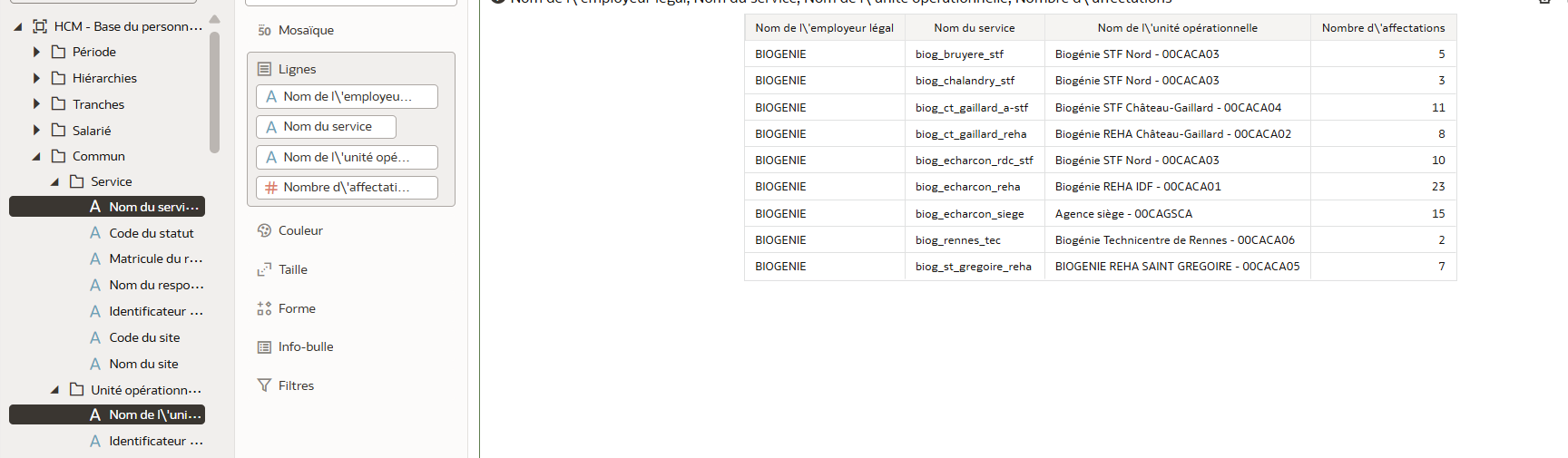

If I filter the legal employer i want (biogenie) and add the department and business unit from the "common" subject area, it works fine.
BUT, if I do the same thing using the hierch org subject area and take the department (level 1 org name) and business unit (level 2 org name), it does not work…

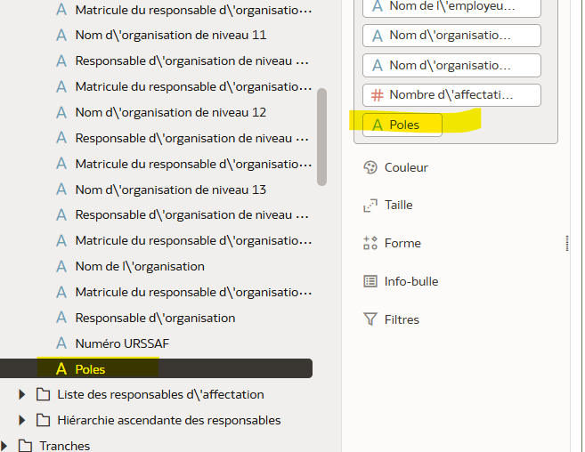

Same if I add the "poles" (that we added as part of the data augmentation).
Could you please explain me why ?
Regards,
Lauriane
