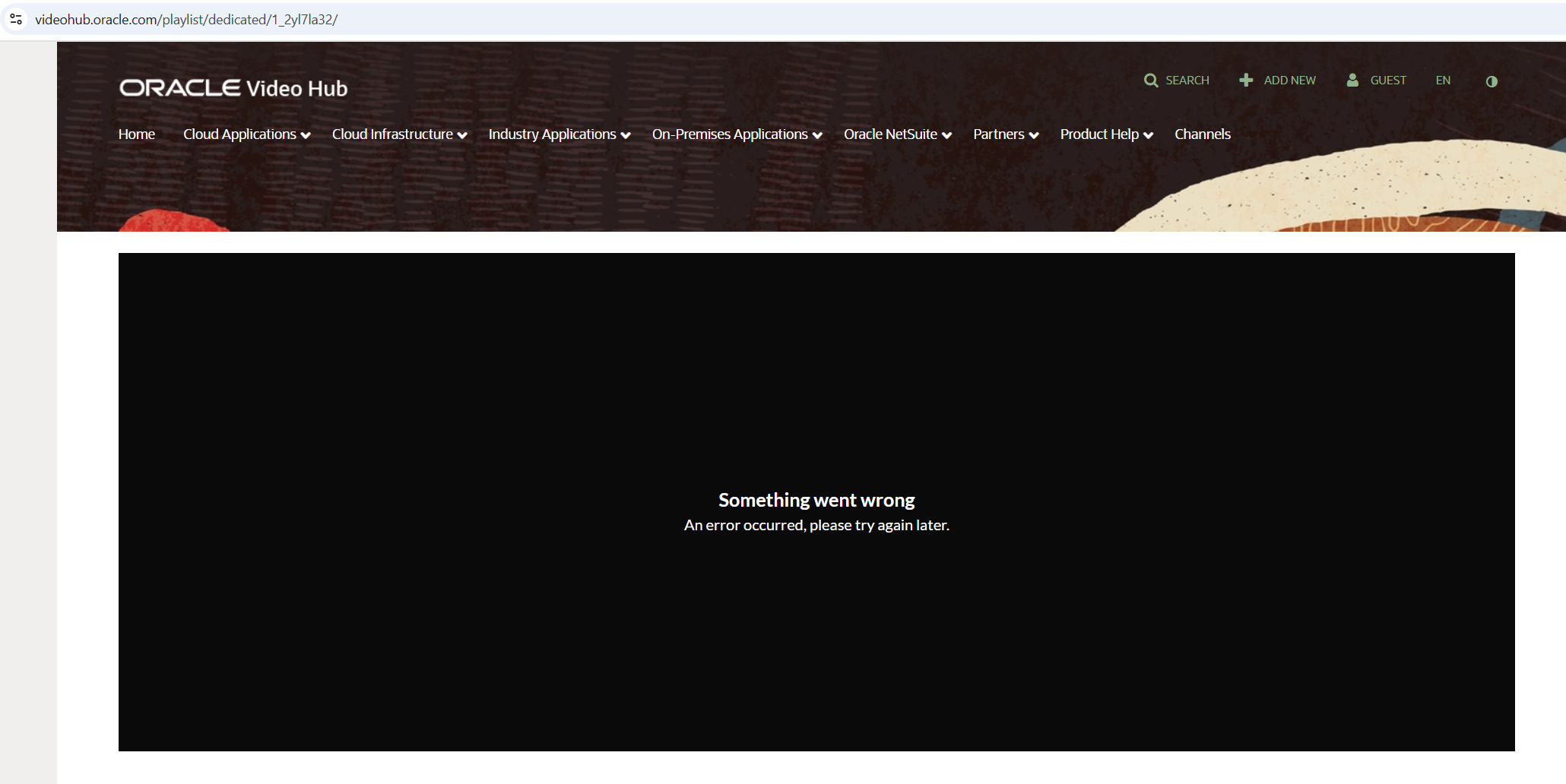

Thanks for your reply. I cannot view the playlist through your shared link. I get an error saying "something went wrong" Can you please provide an updated link?For your earlier comment, are you saying that this kind of data blend is only available if we enable and configure CAA? We are hesitant to do this because we have so many workbooks and trained all users on using the GL Account Analysis subject area. Or is a way to do this using the GL Account Analysis subject area with one of the AP Invoice subject areas while still being able to pull in Payment Date from the AP Payments subject area?

@Molly P Pl check this link. It is working for me
https://videohub.oracle.com/playlist/dedicated/1_2yl7la32/
0 -
@Jamie Anderson-Oracle thank you for the clarification. The link to the snippet video does work so I will review.
@Navnit Mishra this link still does not work for me. Do I not have access/need an account or something?
