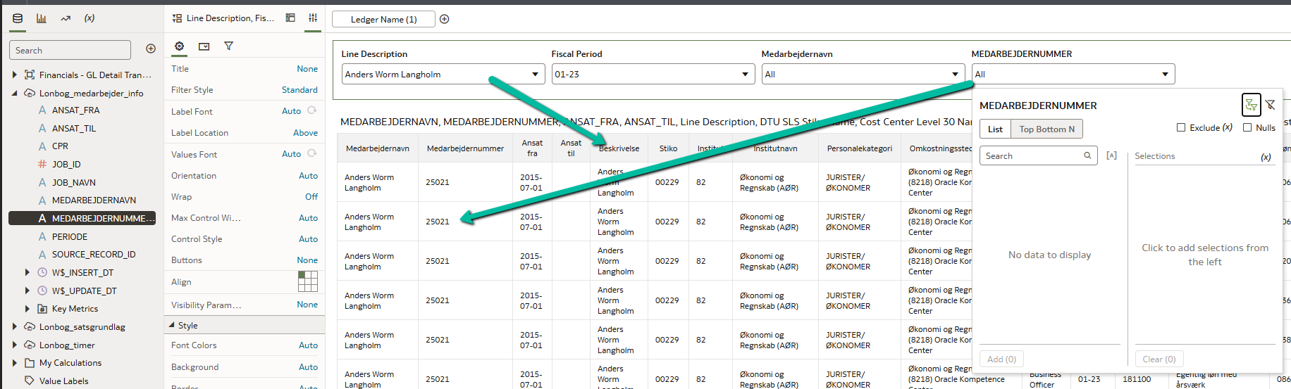

I have created a table with columns from both dataset 1 and 2, and it works perfectly.
Then I add columns from both datasets to a dashboard filter, and then my troubles begin… 😅

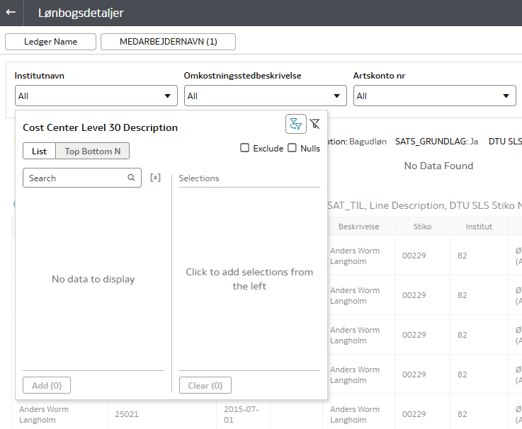

When I filter on a column from dataset 1, the filters from dataset 2 turns blank, even though there are still values from dataset 2 present in the table…?
In the example below, I filter on the line description (Beskrivelse in danish, sorry 😋). Then the column "Medarbejdernummer" from dataset 2 is present in the table, but dissappears in the filter… WHY? 😄
It's really confusing, if there is no relation between then tables in this way…

I have tried to filter on the column "Medarbejdernavn" from the table "lonbog_medarbejder_info" and then all the filters from the local subject area "Financials - GL Transactions" are empty, even though there is a clear connection and data from both tables are connected and present in the data object as shown in my first post.
When I filter on "Medarbejdernavn" from "lonbog_medarbejder_info", nothing happens - the data table just keeps loading, but the filters from "Financials - GL Transactions" turns empty…
So there is a relation between the tables in the data diagram, I just only get data, when filtering on columns from "Financials - GL Transactions" and no matter what I do, once I have chosen a filter from one of the tables, I can only choose to filter on columns from that table, the rest are empty…
