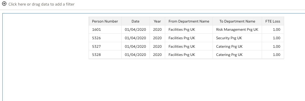

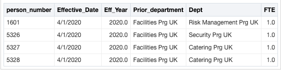

Has anyone figured out the query/report using OTBI for the validation of these 2 key metrics from the Gains and Losses subject area in FAIDP/FDI? Any help would be highly appreciated.
Hi @pwc123 Validating it from OTBI requires logical sql queries. In the attached example I have the validation for FTE Loss for a specific Department named 'Facilities Prg UK' in the Year 2020. You need to do something similar for other workforce structures like Job, Grade, BU etc. There is a similar post in OTBI, you can check that as well. I have posted the link below.

OTBI Output
FDI Gains and Losses Output

Thanks @Raghavendra Raghunath-Oracle. So we’re saying that this can only be validated at the employee/person number level, not for a whole department or a whole BU?
Hi @pwc123 No, what i meant, you can arrive at gains and losses using the grain of the worker.
This is in OTBI, for your validation
This aggregation is available OOTB in the Gains and Losses subject area
