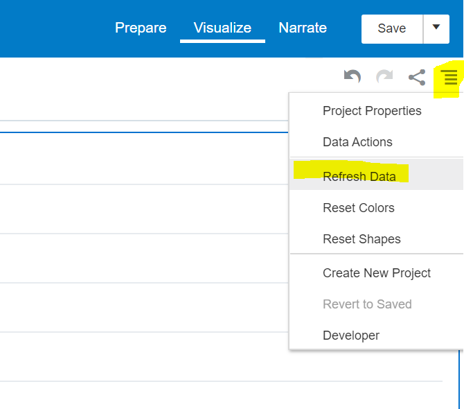

    Could "Refresh Data" be a solution? I don't really use cached sources, so never tested it, but in classical OBIEE it's the way to force the system sending a query to the BI server instead of just using the front-end cache like F5 does.

    See thread "data sync question"   We are already clearing via the Data-Sync ETL  however, that does not fix the issue within DVD.  Question;  When you run "Refresh Data" within the project does that have the dataset call the ADW or does it just refresh with the local dataset?   We need the local datasets that are set to cache to refresh once a day.
