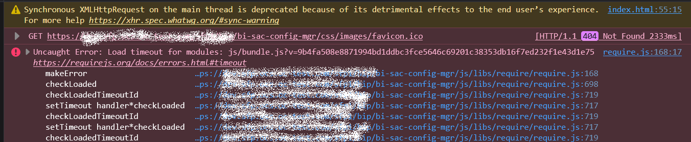

And on browser inspection this is the error

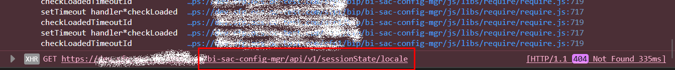

The last redirection is not happening correctly,
it is directly hitting, "/bi-sac-config-mgr/api/v1/sessionState/locale", without including prior redirection path,

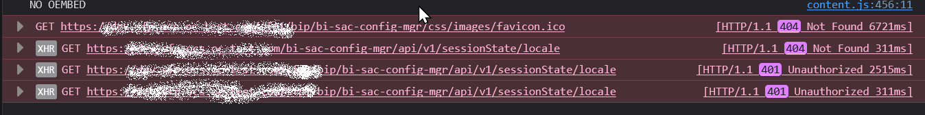

On browser, live I have edited manually & triggered again with right redirection then 401 Unauthorized..
Here the last 2 trials are, after manually updating & resending the redirection
