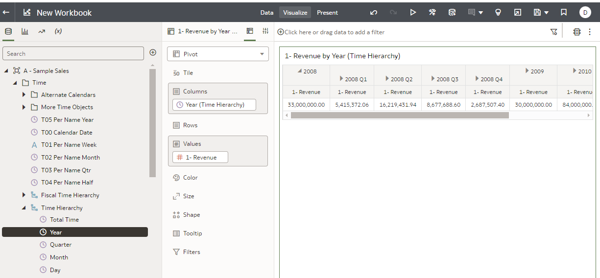

From this link https://youtu.be/PBxADXChCqw
I found out that it has hierarchy columns of date, but when I tried to upload dataset (or create dataset from Database connection), it does not show as the video described (not in hierarchy form)
Not hierarchy form (what I have)
Hierarchy form (what I want)

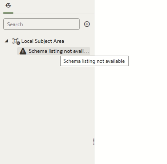

  • Do I need to use Subject Area to create hierarchy columns? (If yes, then what is the difference between normal dataset and subject area)
    • And how to create subject area? because mine shown as attached picture image.png

    DV is capable to rendering hierarchies; however, they need to be defined in a subject area (Semantic Model / RPD ) for the datasource, prior to building your workbook.
    Here is an example from a Local Subject Area (i.e. - dataset from a Subject Area)
    The time levels when expanding a dataset date field... are not really a time hierarchy - those are just options for extracting / deriving level based columns like Year / Quarter / Month.
