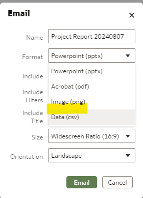

Greetings Community, can anybody confirm if there is an inability to send "Excel" versions of NSAW Workbook via Email
I mean we can regularly Export Excel out of Workbook

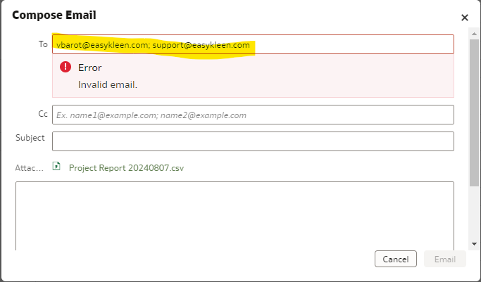

Secondly, Multiple Email Addresses in "To" and "Cc" doesn't work either. I'm applying the right format to separate by ";".
Please share your insights on these issue.

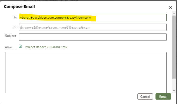

No it wouldn't give the same error, I tried it earlier and worked fine.
FYI for everyone, this was self-resolved by removing the " " (blank space) between semi-colon and 2nd Email.

- The excel version to be attached by email is planned on the product roadmap. It's not available yet.

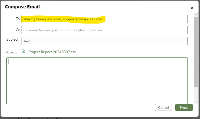

- After entering an email, I believe you need to separate by a comma each email.

@Vismay Barot - As informed by Benjamin, when using multiple email IDs they should be comma separated. It appears you are using semi colon.

Thank You @Benjamin Arnulf-Oracle & @Sumanth V -Oracle , I tried separating by comma:
And this is what I receive when I hit "Email" button:
Not sure where exactly things are falling apart since I can successfully send email with 1 Address in "To" and 1 Address in "Cc" but cannot send when I put 2 Addresses in "To" separated by ",".

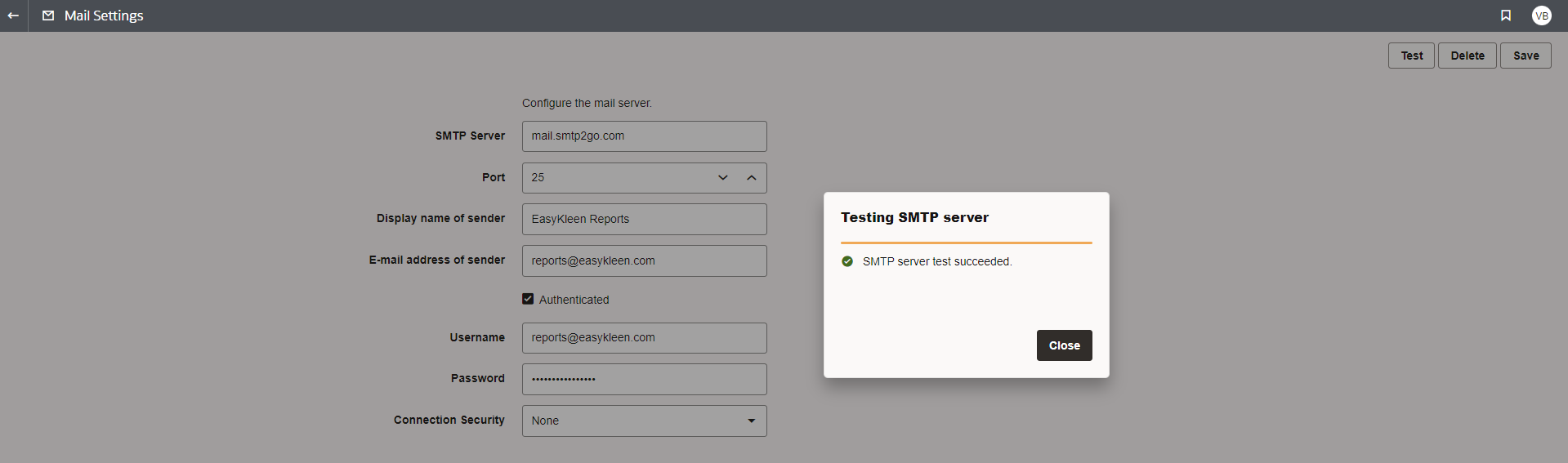

@Vismay Barot - Please confirm if the SMPT server settings have been configured correctly. Also, could you clarify if it successfully gets delivered when using a single email address?
0 -

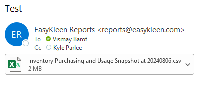

Yes, it successfully delivers as below (Outlook Snapshot) if I put 1 Addressee in "To " and 1 Addressee in "Cc":
Which is why I don't think so if something is wrong in here:
Please let me know what could be a possible solution.
