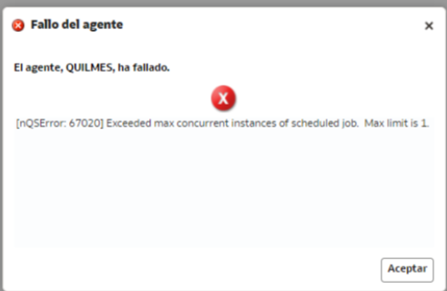

Hi! I need to run an agent, but I get the error
[nQSError: 67020] The maximum number of concurrent instances of a scheduled job has been exceeded. The maximum limit is 1.
I see the same agent that I need to run in the Manage Agent Session view, so I want to cancel it. How can I do this?

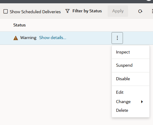

Users can cancel any delivery that they own.
Admin user can suspend temporarily the agents which are created by other users
Console> >Monitor Deliveries >Action menu
0 -
Thank you @SivaB -Oracle, but that doesn't work either.
We have restarted the OAC service, but the agents are still visible in the Manage Agent Session view:
and I get the same error when I try to run the agent:
