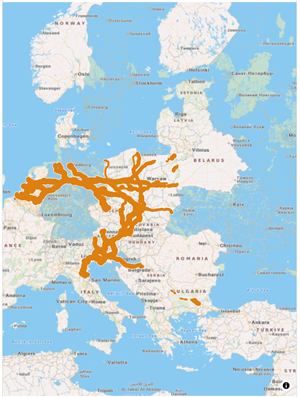

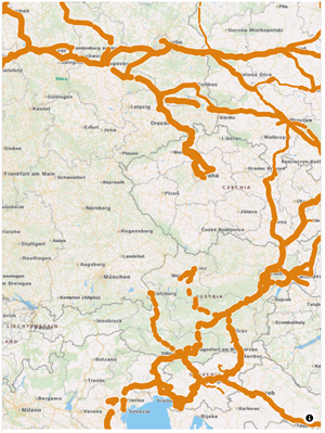

after upgrade of OAS 2023(7.0) to OAS 2024(7.6) - Linux version - I have issues with included Background maps on different zoom levels with DV. On previous version I had no issuses but now like that on different zoom levels some countries are not shown properly.

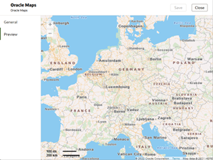

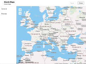

Checking maps on Console/Maps/Backgrounds/Oracle Maps I have correct image on all zoom levels, but using these maps on workbook it doesnt show properly on some zoome levels.
On higher level it shows like some countries are missing:

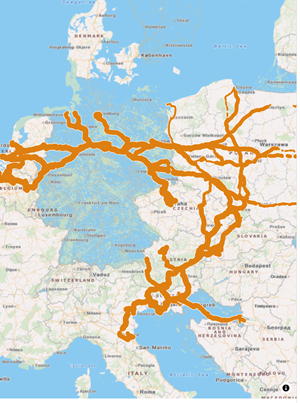

Then after zoom in it shows strange like water:
More zoom:

When checking the same maps on preview pane of Console/Maps/Backgrounds/Oracle Maps it shows correct image on all levels:
