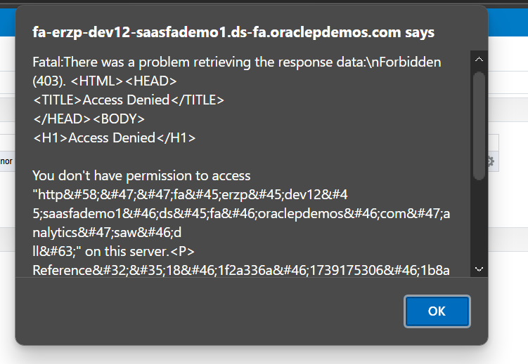

i was trying to fetch the absence donation Recipient details like (First name Last name of Recipient and Alias details ) i was not able to drag and drop those columns. It says "There was problem retrieving those response data"
Note - User has all the necessary roles add to his account
Please find the error screenshot

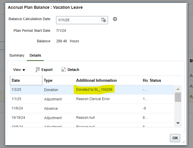

Looks like you are using a demo instance. Are you able to confirm if you are able to see the details from application UI?
Thanks.

Since you asked to add the BI Admin role and test it. still facing the same issue
Note - It is demo instance

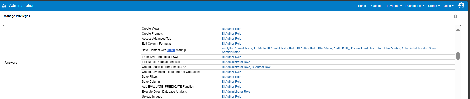

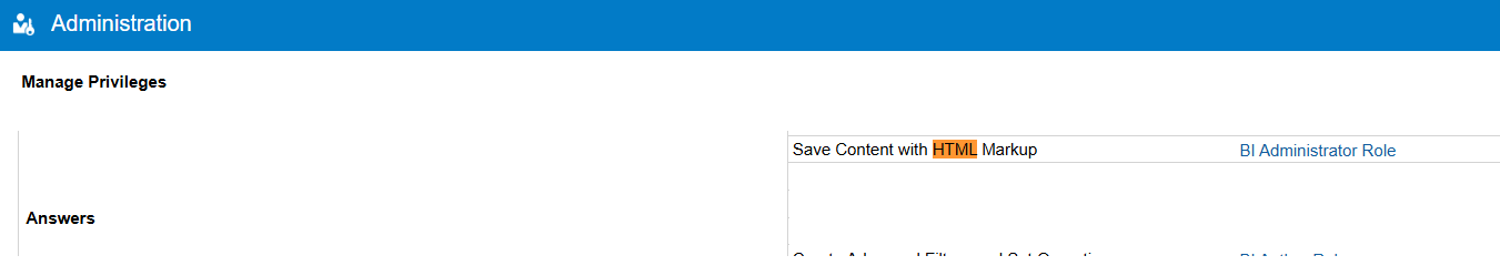

Can you please check what settings are there in your env for following?
Also:

here is the screenshot for the settings in our Environment
