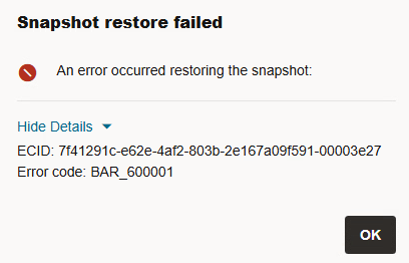

After importing the .bar file through Snapshot in DV, I get the error: The error code is: BAR_600001
I ran a test importing the components separately, and this was the result.
Restore Snapshot:
1. Deployed Model (RPD) - success
2. Jobs - success
3. Configuration and Settings - success
4. Application Toles - success
5. Credentials - success
6. Classic Content - It was a failure
a. Catalog Content - It was a failure
i. Shared Folders
b. User Folders and Personalizatiosn - It was a failure
i. Workbooks
That is, the error occurs with the Catalog Content. Can someone tell me what might be happening and how to solve it?

    Please check \importbar_<date>\webcat_content_plugin.0.0.log to see details of why the webcatplugin failed. Do you have HashUserHomeDirectories setting in instanceconfig.xml file?
    If yes please follow workaround steps in this KM doc for import to succeed: Content From User Folders in Hashed Catalog Is Not Migrated From OBIEE 12c to OAS (Doc ID 3021637.1)
    Thanks
    Gayathri
  • Gianni Ceresa
    edited Jun 25, 2025 3:08PM
    What Gayathri said: the logs in <domain>/bilogs/metadata/importbar... are extremely (almost too much) detailed and do contain all the details pointing at what went wrong in the process (it can really be a long log, read it carefully to avoid false-errors that aren't the real root cause but a consequence of it).
    Based on the root cause, then you can take the required actions to prevent/avoid the error.

    When I restore the .bar file in the Snapshot, the import only fails when I have 'Classic Content' checked.
    If I uncheck 'Classic Content', the import completes successfully.
    While the snapshot is being restored, it creates the directory importbar_20250625_201449_2091284203, but it's empty, and when the restoration finishes, it’s no longer there — it disappears.
    oramid@server:~/app/oracle/product/domains/oas_domain/bilogs/metadata/importbar_20250625_201449_2091284203> ll
    total 0
    oramid@server:~/app/oracle/product/domains/oas_domain/bilogs/metadata> ll
    total 0
