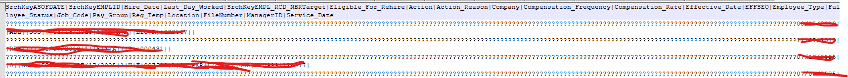

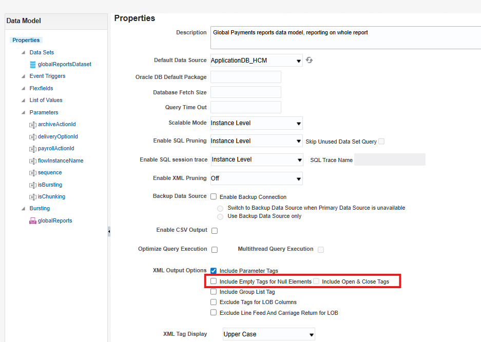

I have tried unchecking , still generating these characters in the front for each row.

Is the snippet you shared from the XML file or the output file when scheduling the report?
Thank you
Hassan0 -
Output file
0 -
