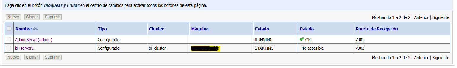

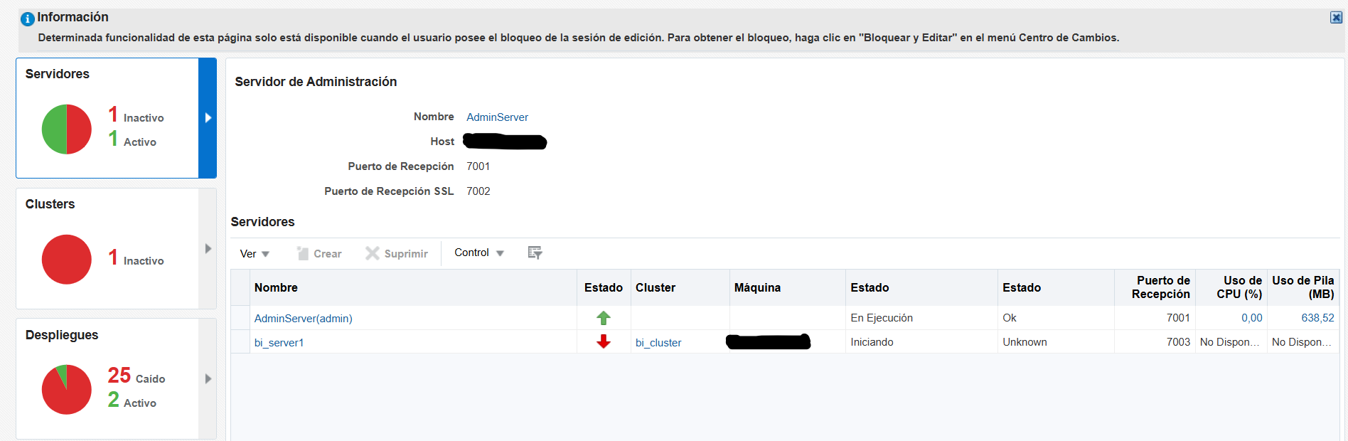

OBIEE 12.2.1.4 bi_server dont start
Hi everyone !!
Please,
Someone who can guide me in the error that I will describe below.
When starting the managed server, it remains in the STARTING state

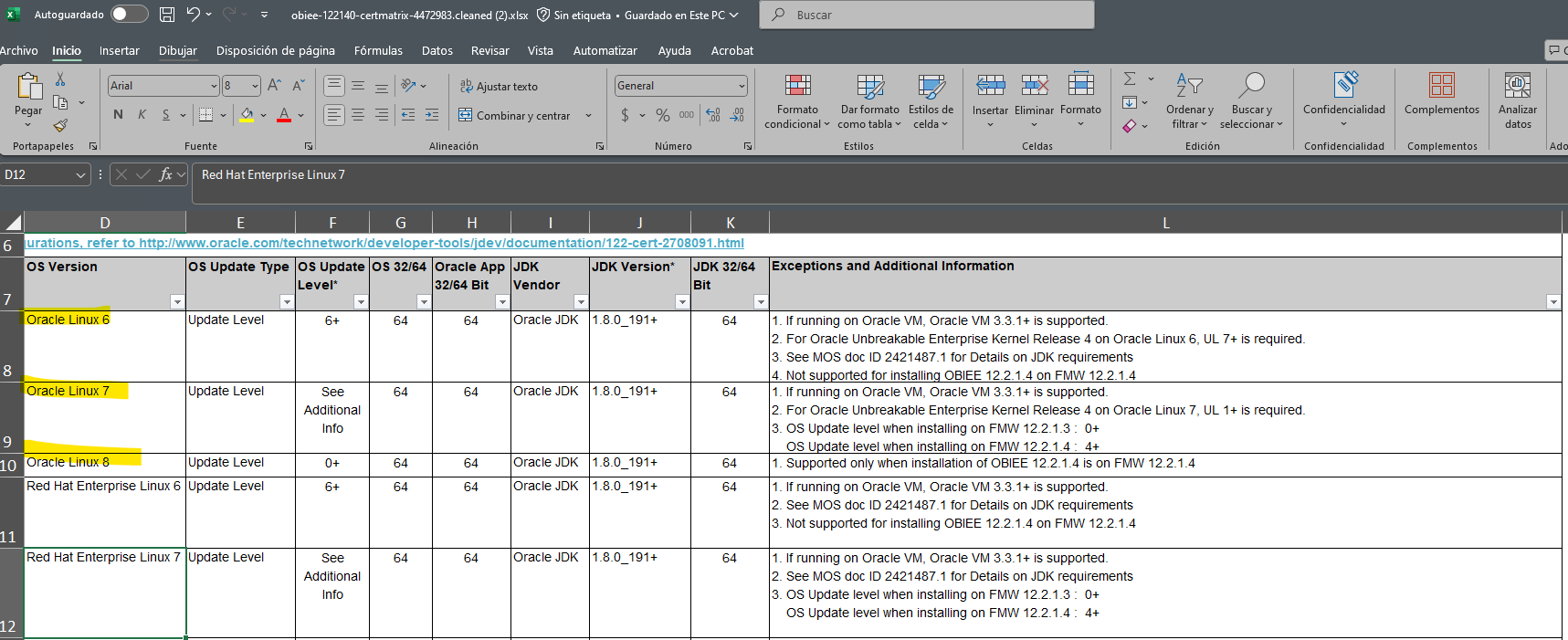

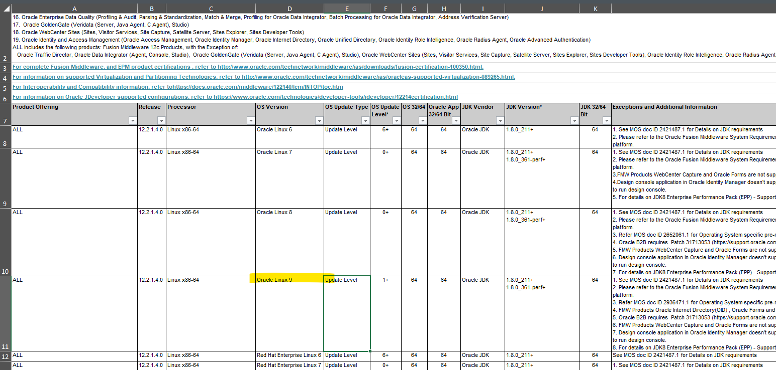

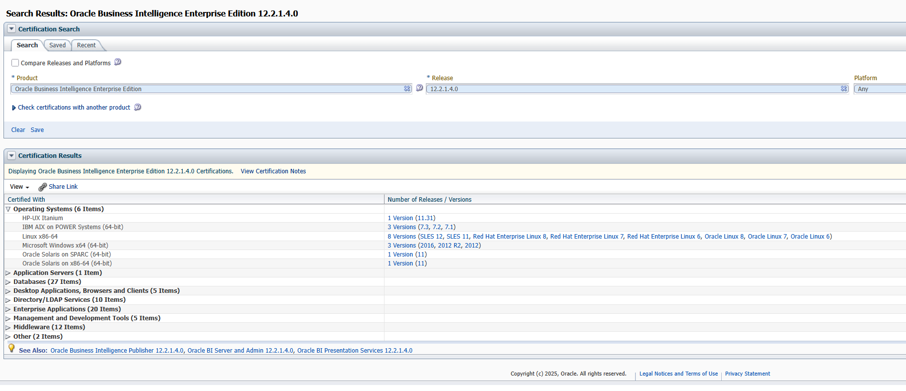

I am currently installing OBIEE 12C with the following features.
SO
Static hostname: host1
Icon name: computer-vm
Chassis: vm 🖴
Machine ID: 322321321313
Boot ID: 5637079046ab44a383cfefd7e9913ac6
Virtualization: vmware
Operating System: Oracle Linux Server 9.5
CPE OS Name: cpe:/o:oracle:linux:9:5:server
Kernel: Linux 5.15.0-305.176.4.el9uek.x86_64
Architecture: x86-64
Hardware Vendor: VMware, Inc.
Hardware Model: VMware7,1
Firmware Version: VMW71.00V.21100432.B64.2301110304
FMW : 12.2.1.4
OBIEE: 12.2.1.4

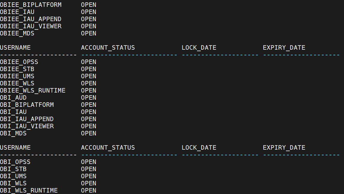

BDLSNRCTL for Linux: Version 19.0.0.0.0 - Production on 27-AUG-2025 11:28:01
Copyright (c) 1991, 2022, Oracle. All rights reserved.
Connecting to (DESCRIPTION=(ADDRESS=(PROTOCOL=TCP)(HOST=DBHOST)(PORT=1530)))
STATUS of the LISTENER
Alias LISTENER
Version TNSLSNR for Linux: Version 19.0.0.0.0 - Production
Start Date 27-JUL-2025 12:46:06
Uptime 30 days 22 hr. 41 min. 55 sec
Trace Level off
Security ON: Local OS Authentication
SNMP OFF
Listener Parameter File /oracle/product/db/19.3.0.0/network/admin/listener.ora
Listener Log File /oracle/product/db/diag/tnslsnr/DBHOST/listener/alert/log.xml
Listening Endpoints Summary...
(DESCRIPTION=(ADDRESS=(PROTOCOL=tcp)(HOST=DBHOST)(PORT=1530)))
(DESCRIPTION=(ADDRESS=(PROTOCOL=ipc)(KEY=EXTPROC1530)))
Services Summary...
Service "01570cbd08477908e063f7da010acdab.XXXX" has 1 instance(s).
Instance "CDBOBIMD", status READY, has 2 handler(s) for this service...
Service "1be46f5677be10e3e063f7da010a2a2c.XXXX" has 1 instance(s).
Service "CDBOBIMD.XXXX" has 1 instance(s).
Service "obimetadata.PACIFICO" has 1 instance(s).
The command completed successfully

<Aug 26, 2025 4:52:09,978 PM ECT> <Warning> <oracle.dms.collector> <DMS-50911> <Duplicated metric table. Metric table oracle_oam:partner_requests will be ignored.>
<Aug 26, 2025 4:52:18,113 PM ECT> <Warning> <oracle.bi.servicelcm_v2.persistence.defaults.DefaultsReader> <BEA-000000> <Cannot read defaults, as path does not exist: /oracle/product/fmw/user_projects/domains/bi_domain/config/fmwconfig/bienv/core/servicelcm/defaults/.>
<Aug 26, 2025 4:52:18,113 PM ECT> <Warning> <oracle.bi.servicelcm_v2.persistence.defaults.DefaultsReader> <BEA-000000> <Cannot read defaults, as path does not exist: /oracle/product/fmw/12.2.1.4/bi/plugins/servicelcm/defaults/.>

Hi FMW is only the base you need to install OBIEE on top fmw and that's not support

Is all your wls repository schemas open and not locked or expired, particularly OPSS and MDS Has anything changed recently
1 -

1. OBEE was never certified on Oracle Linux 9. Oracle Linux 8 was the last certified Linux OS for OBIEE 12.2.1.4 with FMW 12.2.1.4
I am not saying it won't work, but advising you that it is not certified; therefore, not supported.
2. Oracle Analytics Server 2025 was the first on-premises Analytics that was certified on Oracle Linux 9, we recommend that you install OAS 2025
You will need to review: bi_server1.out, bi_server1.log, bi_server1-diagnostic.log, and nodemanager.log to determine the root cause. In addition to the heap memory provided to the JVM and the physical memory.
The bi_server1.out snippet above has no errors, only warnings for the managed server.1 -

FMW 12.2.1.4 if it is certified for Oracle Linux 9x
@Melanie' thank for yo response, If I am reviewing the documentation for the possibility of migrating from an OBIEE 11g version to OAS 2025, I am going to perform the 2 exercises, migrate it to OBIEE 12.2.1.4 and also to OAS 2025 to see the results, logically the OAS 2025 option would be recommended by support.
