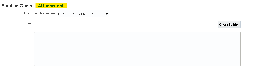

How to use attachment tab in datamodel ?
Hi Experts,
How can I attach FAQ document to the bursting query? I could see a attachment tab next to busting query. Can anyone share sample query to get document from content server?
Ref:
Regards,
Nivya
Answers
You will need to upload the FAQ to content server and then write a SQL to pull it from there in attachments section.
Please check the step by step instructions on below link:
Adding External PDF attachments to bursted PDF output
Thanks.
