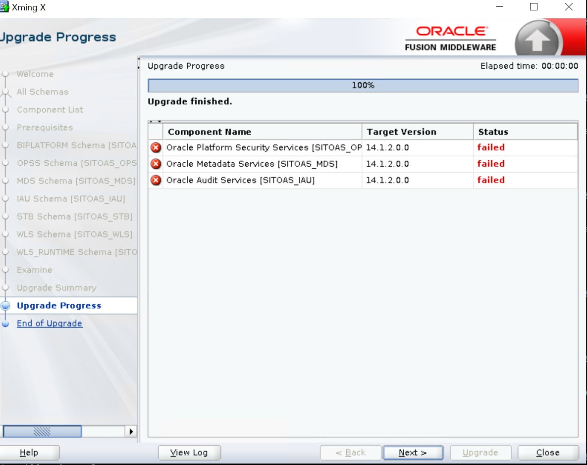

However, during the Upgrade phase, the process fails immediately for the following schemas:
OPSS
MDS
IAU
The failure is associated with an "Invalid DB Role" error.

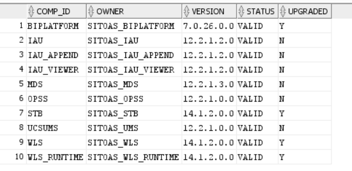

After each failed upgrade attempt, the DBA team manually updated the schema_version_registry table to reset the status of the OPSS, MDS, and IAU schemas back to VALID.
We verified that the reset was successful by confirming that the status for all three schemas was set to VALID in the registry.

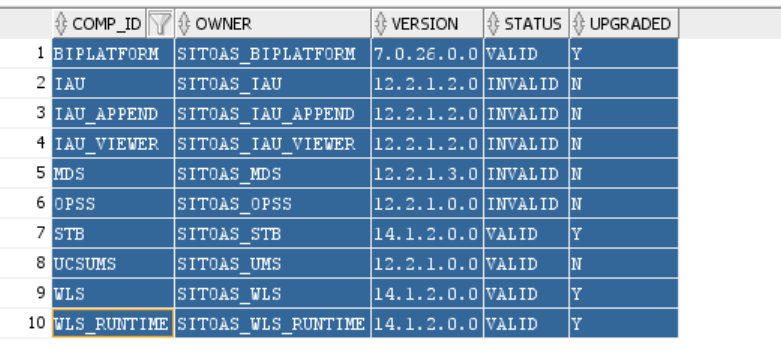

Despite resetting the schema statuses to VALID, the upgrade process fails again with the same "Invalid DB Role" error. Additionally, after the failure occurs, the Upgrade Assistant automatically updates the status of the affected schemas back to INVALID in the schema_version_registry table.

    Regarding KB605325, it refers to updating the WLS schema parameter. However, the issue we are encountering is that while running the Upgrade Assistant, the status of the affected schemas is automatically being updated back to INVALID in the schema_version_registry table on the database side.
    This behavior seems to be occurring during the upgrade from OAS 2025 to OAS 2026(12.2.1.4 to 14.1.2) and it appears that this may need further investigation from the Oracle side to understand why the schema status is reverting to INVALID during the upgrade process.
