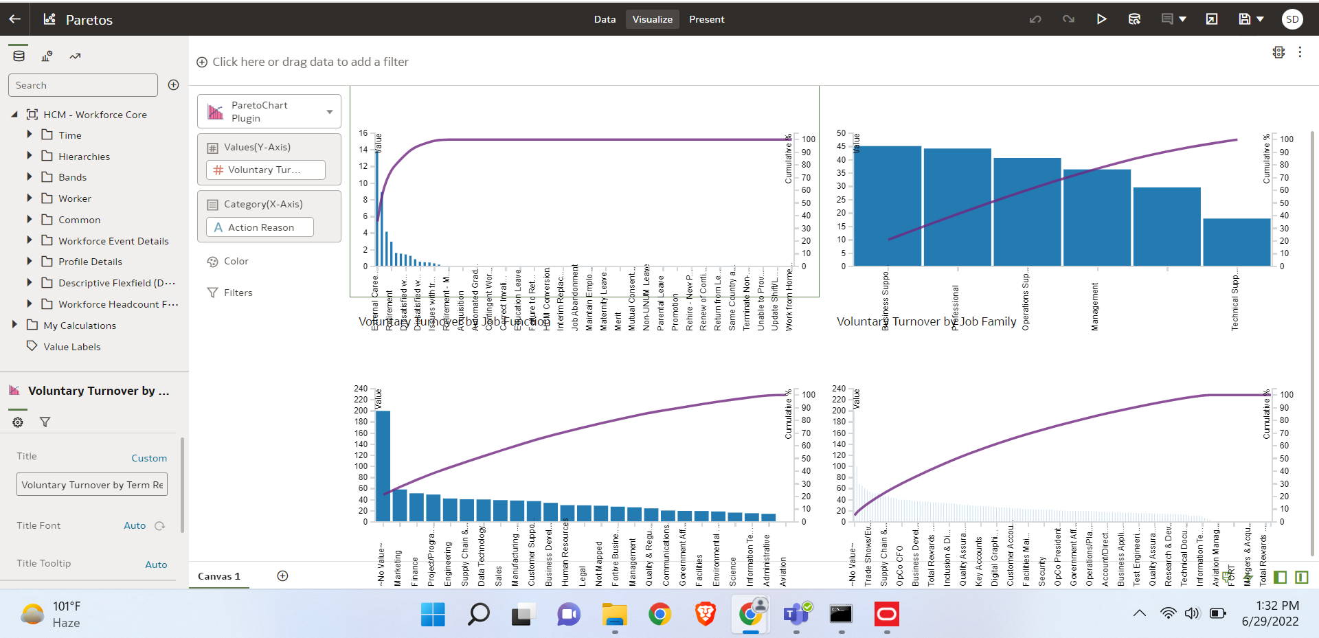

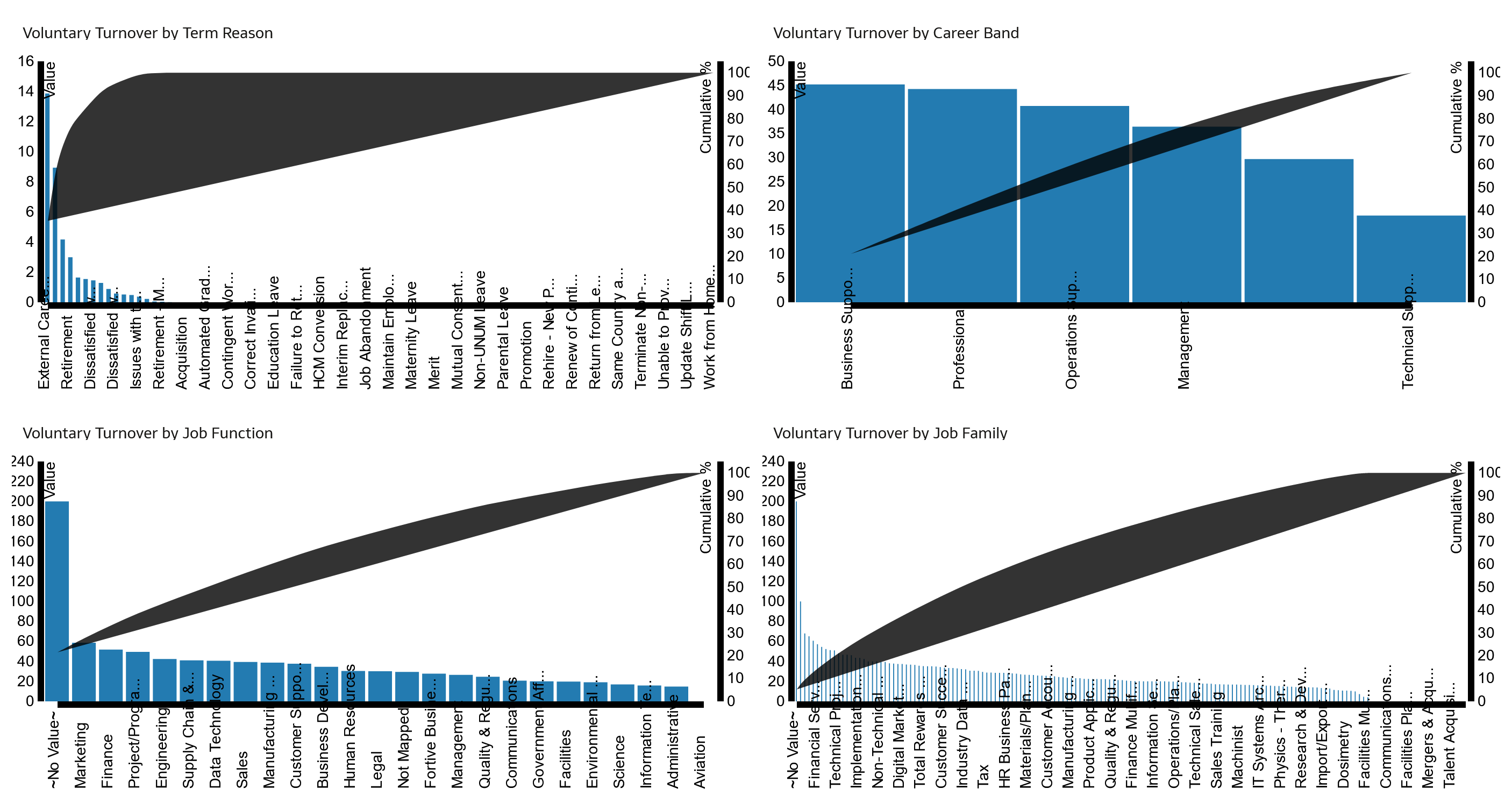

I have tried using it and as it is a custom plugin, export is not working properly. Also if you put your canvas height to grow and try adding more paretos in a single canvas, It is not scrolling the graphs.
Attaching some screenshots here to explain the problem.
0 -
