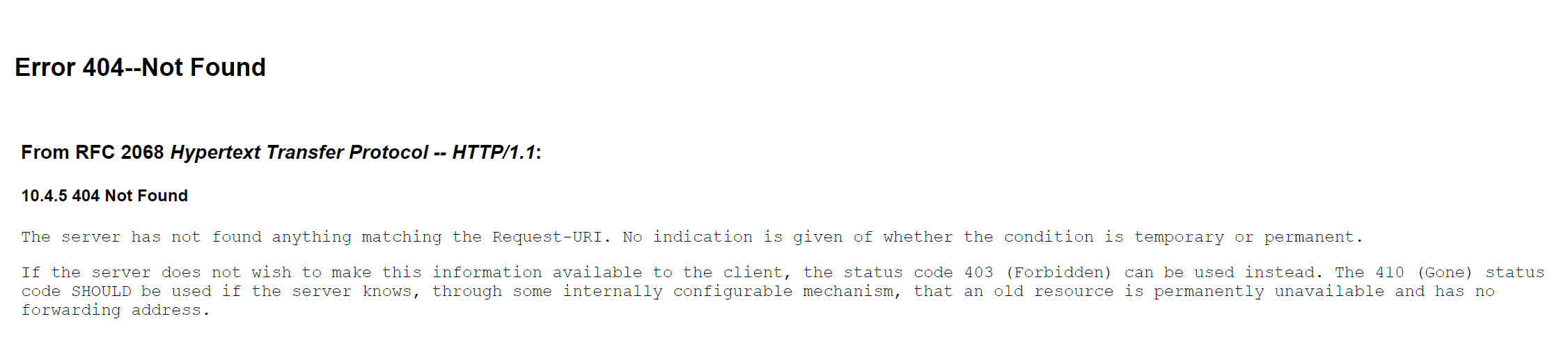

Em Page Error:
http://xxxxxxxxx:9500/em
Missing all options under Console (http://xxxxxxxx:9502/dv/ui/home.jsp?pageid=console

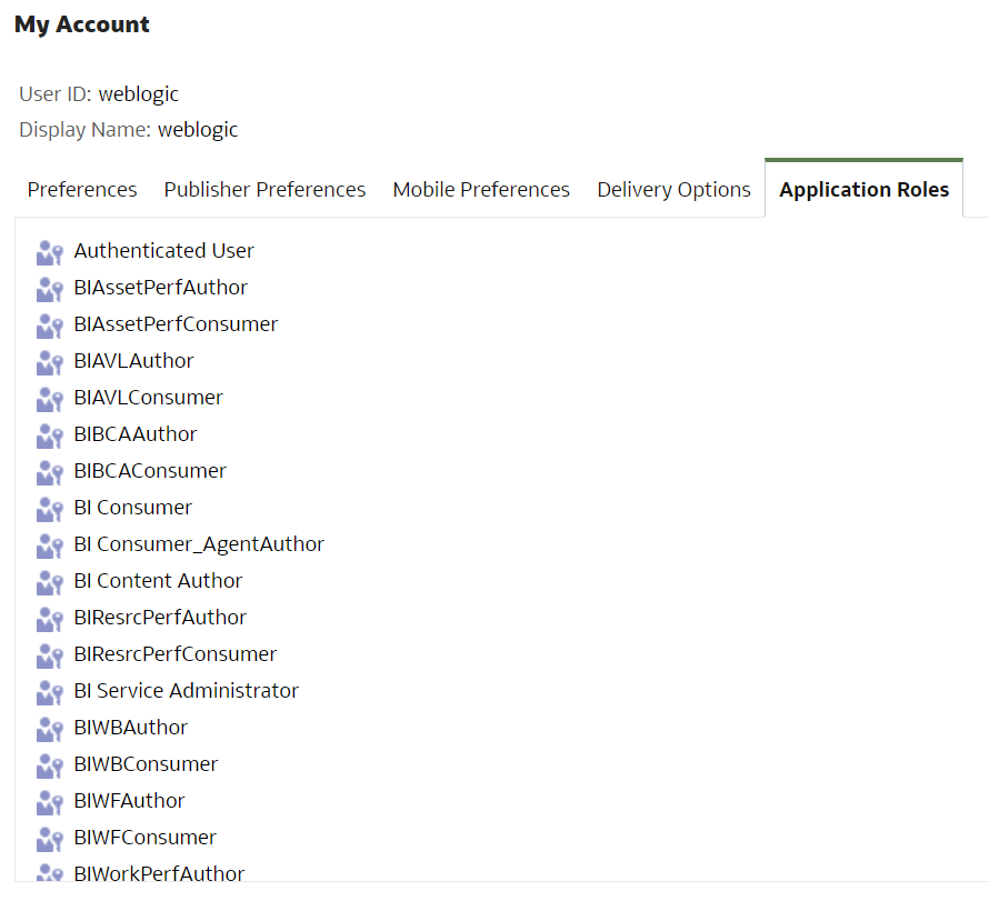

    BIServiceAdministrator is the default application role in OAS that allows you to manage the application, and the administrator user created during the installation is member of it.
    Since you restored an OBIEE snapshot, you should double-check that your administrator user is actually a member of the BIServiceAdministratorRole (e.g. login to Classic Analytics, click on your profile icon and select MyAccount). In the past BIServiceAdministrator used to be called BIAdministrator and there is a chance it has been migrated with that name to OAS from old OBIEE versions in your case.
    BIServiceAdministrator (or BIAdministrator if you are still using the old naming convention) is expected to have all permission sets, so you can safely run the command with all the options listed in the documentation.

    i have run the below command to grant all policies and restarted the server. still, i have the same behavior em login page won't come up and all options under dv/console missing.

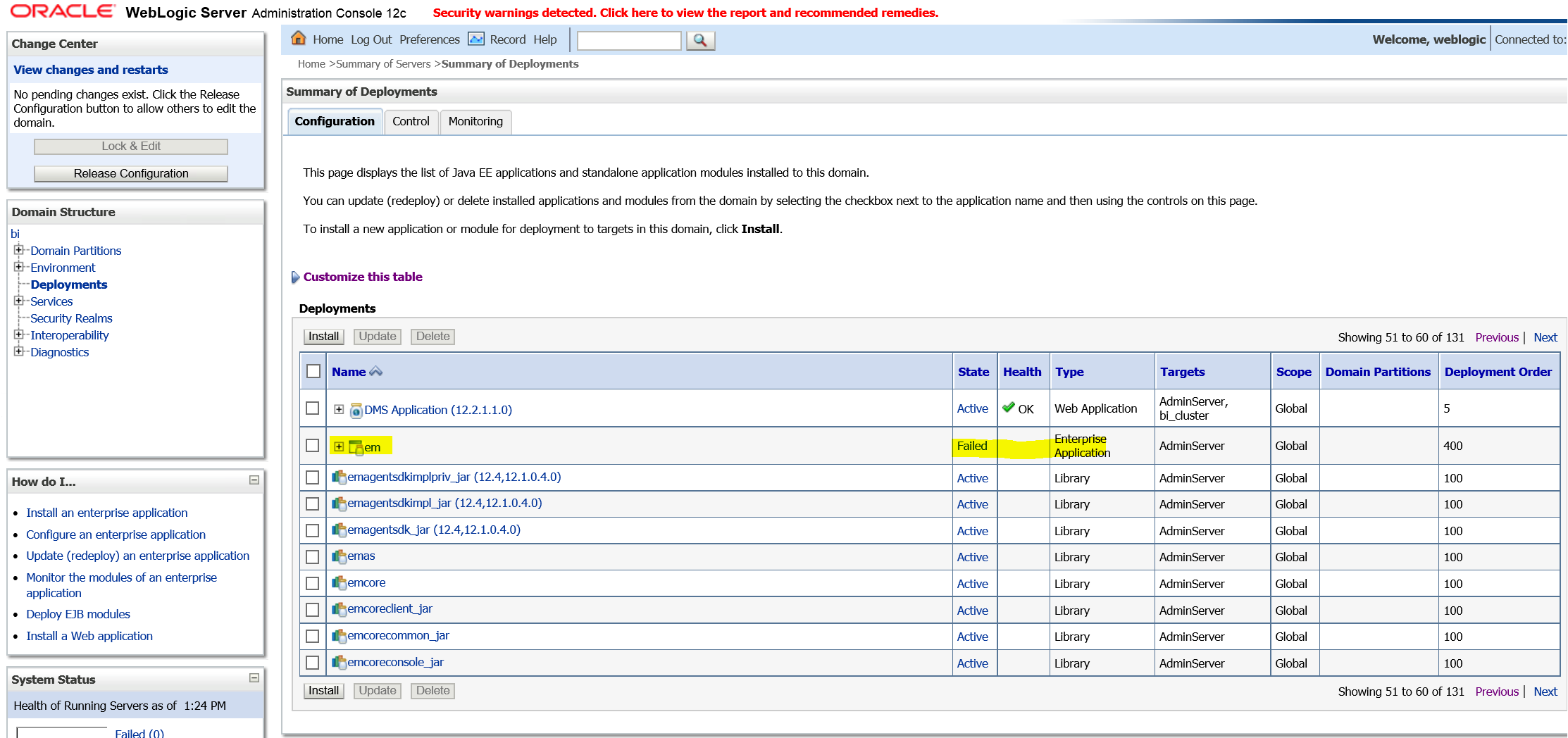

    em is in the failed state

    @Federico Venturin
    administrator user created as part of the OAS installation is Weblogic and he is part of the BIServiceAdministrator role, verified using my account option on the analytics console.

    we are doing only the out-of-place upgrade, based on the document i have verified the source path for em deployment in the config file.
    Current Code: in the path for em.ear it has all backslash until bi and frontslash before em.ear and all other ear paths in the file have front slash only in full path, it may be the reason
    <app-deployment>
    <name>em</name>
    <target>AdminServer</target>
    <module-type>ear</module-type>
    <source-path>D:\oracle\product\oas-2024\user_projects\applications\bi/em.ear</source-path>
    <deployment-order>400</deployment-order>
    <security-dd-model>DDOnly</security-dd-model>
    <staging-mode>nostage</staging-mode>
    </app-deployment>
    changed to below
    <app-deployment>
    <name>em</name>
    <source-path>D:/oracle/product/oas-2024/user_projects/applications/bi/em.ear</source-path>
    </app-deployment>
    Will restart the server and will update if it resolves the issue or not.
    same behavior after restart, em is in failed and below is the error message from adminserver log
    <BEA-149004> <Failures were detected while initiating start task for application "em".>
