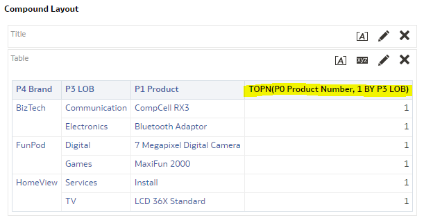

  • An example of what I mean…
    If I want to display only 1 product by LOB, and I want the product with the higher Product Number.
    TOPN("P0 Product Number", 1 by "P3 LOB") displays 1 because it does display the ranking of the row, because you only return 1 row per department, it will always be 1. Doesn't matter much in the end, you don't need that column, hide it (but keep it in the view to make sure the granularity is at the right level).
    But the result is exactly what I wanted: a single row for each LOB, and display the product with the higher product number in it.
    The TOPN column being pointless, you can hide it.
    Job done :)

  • Thanks to that column "lead_rank", you can use that to do the job. For example something like TOPN("your table"."lead_rank", 1 by "your table"."department") would do the job. You could also use RANK (by department) and then filter on that.

  • In my example I posted an example of TOPN using by, by using the "by" piece, you change the level on which the function is executed. And TOPN doesn't really care what is the higher number, it just rank by that and filter the number of rows based on your parameter.

    Thanks Gianni, TOPN("your table"."lead_rank", 1 by "your table"."department") approach worked, the example you provided was very helpful, thanks again.
