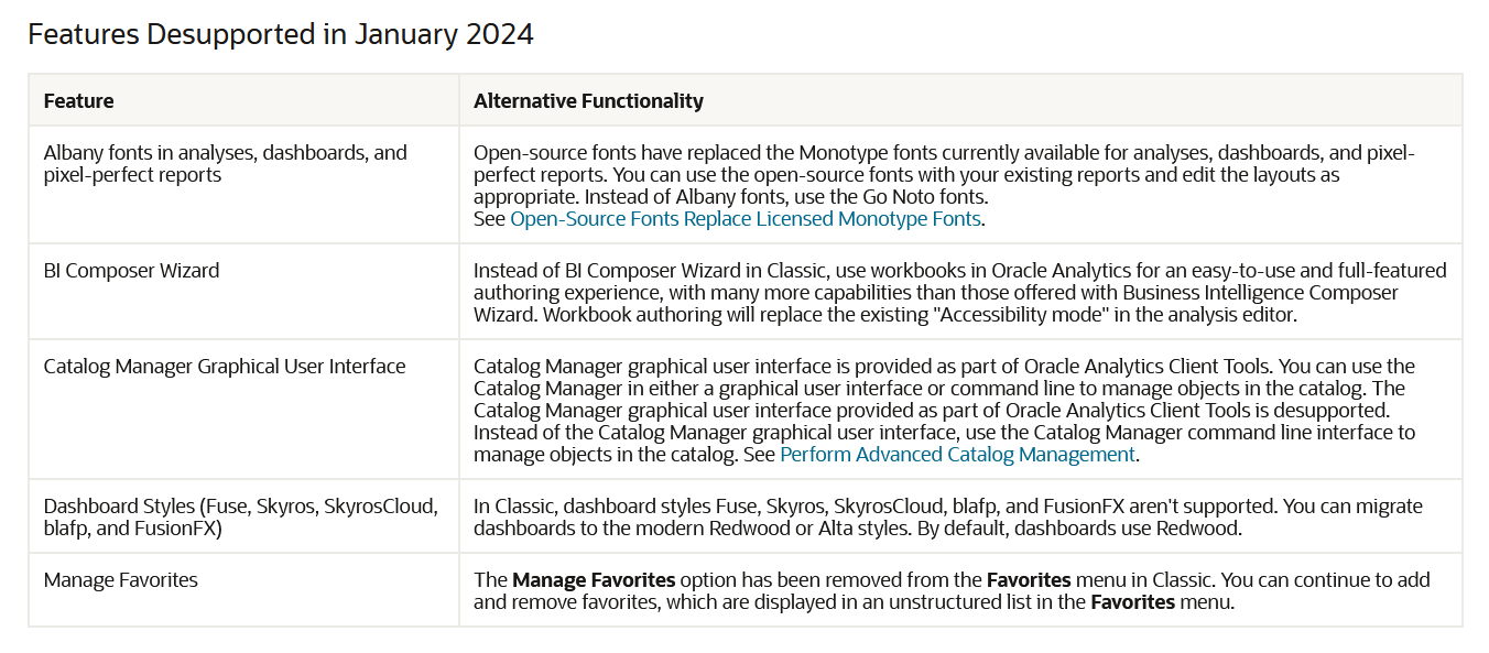

    @Jean-Pierre Hoedenaeken - Starting Jan 2024 Update of OAC, Catalog Manager Client Utility is no longer supported. Instead of the Catalog Manager graphical user interface, use the Catalog Manager command line interface to manage objects in the catalog. See Perform Advanced Catalog Management
    Reference: https://docs.oracle.com/en/cloud/paas/analytics-cloud/acswn/

    Oracle isn't providing a graphical UI for Catalog Manager anymore in recent version of the client, they give you command line version only.
    But the Catalog Manager didn't really change over the past years, therefore if you have an existing Catalog Manager before January 2024 that has a graphical interface, it does work just fine.
    The Catalog Manager does call webservices which do not care if it's graphical or command line, it's the same. The graphical part is on your side in the client installed. Keep around a older (before January 2024) client to have a graphical Catalog Manager, and keep using that.
