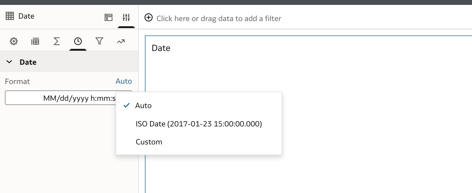

    Please try the following steps and let us know if it helps resolve the issue:
    1. Change the format of the date column back to Auto, then attempt the export and validate if it works as expected.
    2. Once confirmed that it works correctly with the Auto format, switch back to the Custom format and check if the issue persists.
    Refer to the screenshot below for guidance on where to locate this setting.
    We encourage you to continue using the community forum, and feel free to reach out to us for any further assistance here.
    This does address issue as Date data is not corrupted eg FIXE2LENGT02ATE
    I am looking to format the output to dd/MM/yyyy
    2.Once confirmed that it works correctly with the Auto format, switch back to the Custom format and check if the issue persists.
    When I switch back to Custom and change the format to dd/MM/yyyy .
    Date data is corrupted eg FIXE2LENGT02ATE

    That worked -
    What the difference in using DD/MM/YYYY over dd/MM/yyyy?
    Looking at your screen shot example image.png - The Auto default to MM/dd/yyyy h:mm:ss
    What is reason behind having format value in lower case as value produced is a date - no chars to be uppercase
