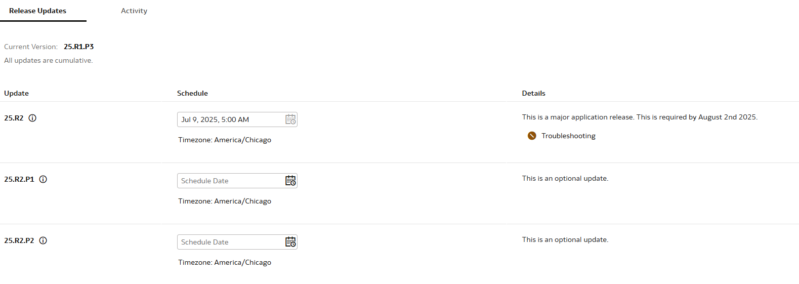

Update 25.R2 was scheduled and stuck on "Troublshooting"
I believe the update actually went through, but when I go to the "Release Updates" page, it shows as troubleshooting.
Is there a way to resolve this?

HI @Ryan Black
Are you using Fusion Data Intelligence or Net suite Analytics Warehouse?
As per screenshot ,your upgrade patch having an issue. Please raise an SR to support team to debug/fix further on patching issue-

This looks like the NSAW update page. I had a similar problem earlier this year.
It turns out that a custom field that we used on an NSAW subject area was the culprit. The subject matter area had changed under-the-hood and it was causing the issue.
Open a ticket - they can look at the backend and see if it's a similar issue (or not) and reset the upgrade path to what you need. They were pretty quick when I submitted.
