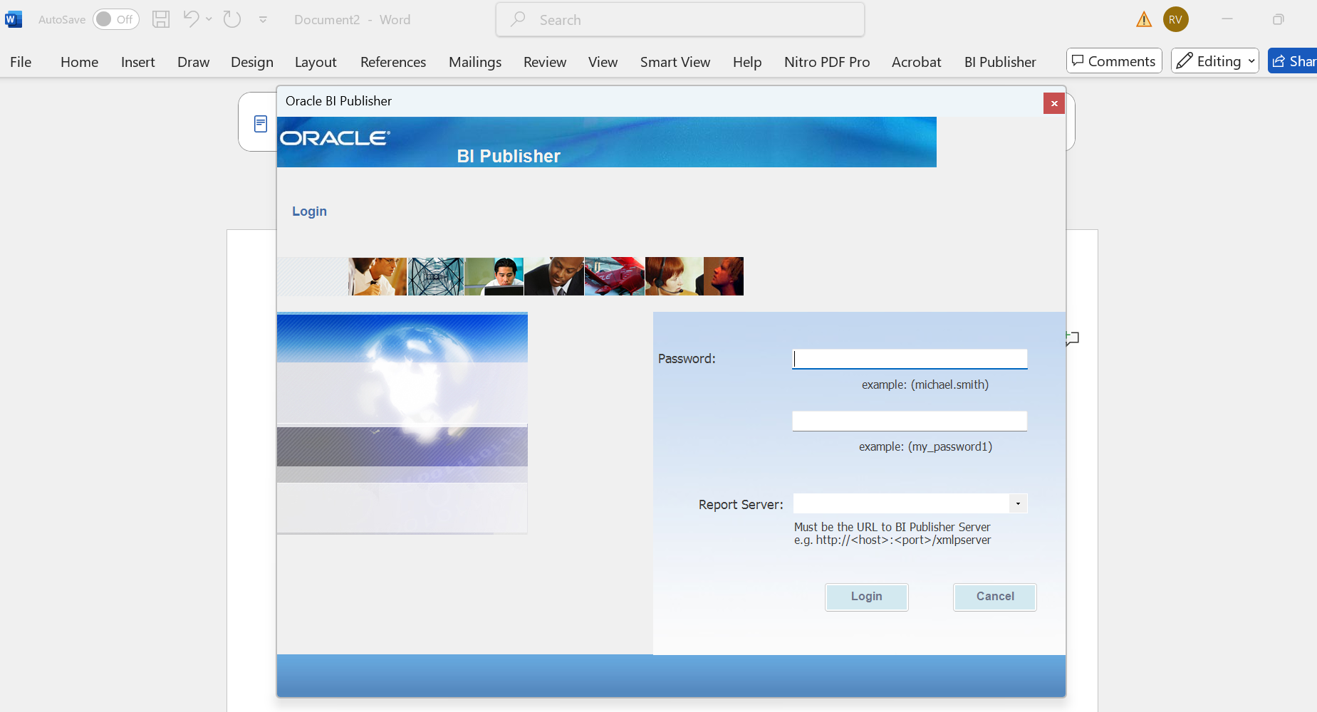

I do not see anything related to FDI in the MS Word. Please refer the screenshot.
Do you have any documentation or steps?
FDI is a package of various products and pieces. What the Word add-in needs is to access Publisher in FDI.
If you take your FDI url, the one that should be /ui/dv or /dv/ui (I never remember which one it is…) and write /xmlpserver instead in the URL, does something display? That’s your Publisher in your FDI environment.
This is an Client Plugin Tool. (MS-Plugin).
You need to enter your username and pwd and application url to connect your server catalog.
Note: create a non-sso user and use the same to connect - .
Refer for more info -
