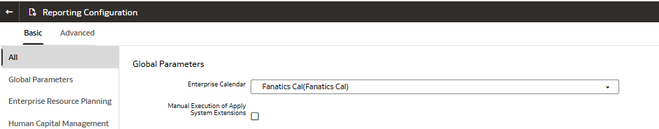

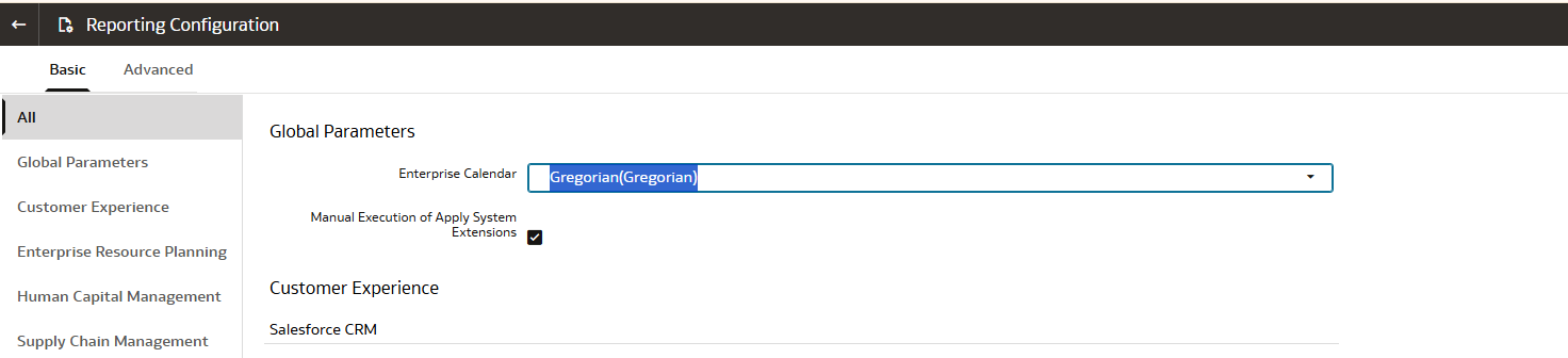

  • Background
As part of ongoing enhancements to improve reporting performance and future-proof aggregate calculations, Oracle FAIDP will introduce a new data pipeline parameter in an upcoming release. The parameter identifies the fiscal calendar to be used as the Enterprise Calendar for your FAIDP instance. It is configured such that, when you upgrade to 26R2, it will default to your present Enterprise Calendar value selection in the Reporting Configuration UI.
However, pipeline parameters UI will not support Gregorian, so, if your current selection is the default Gregorian option, you need to switch this now.
If you are already using a fiscal calendar as your Enterprise Calendar, the reporting config setting should show a fiscal calendar selected, so no action is needed.
  • What you need to do and Why
Reporting Config UI:
Select a fiscal calendar from the Enterprise Calendar drop down in your Reporting Configuration UI. The current 'Gregorian' option in your environment will not get transferred over with the 26R2 upgrade. If there is no fiscal calendar that aligns with Gregorian, then create a temp fiscal calendar that mimics Gregorian and pick that.

Frequently asked questions
My reporting config setting already points to a fiscal calendar for Enterprise. Do I need to do anything?
No, you don’t need to do anything now.
After I make the suggested change, will my reports function as before? Is there any impact?
Your reports should show the same data/results as before because you are switching the reporting config to a fiscal calendar that follows Gregorian (Jan - Dec) .
How do I benefit from doing this?
You will benefit in the longer term in terms of improved report performance. This step will help FAIDP development to introduce design changes at the backend for reports using Enterprise Calendar to run faster.
What is the risk if I don’t take this action now?
All your reports that depend on Enterprise Calendar will show no data when your instance is upgraded to 26R2.
