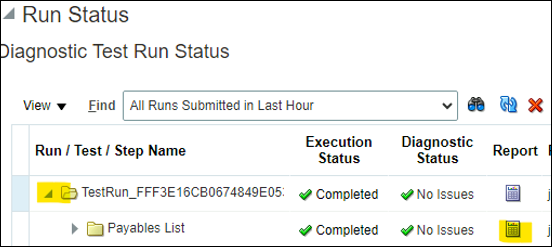

This issue impacts all reports I run via "Run Diagnostics Tests" here:
I can e.g. run a Payables List job here:
View the output here:

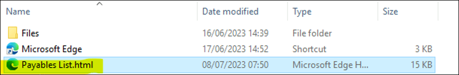

Open the output in the browser, and save as HTML only:
The saved files are generally small:

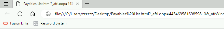

When opened the page it is blank:
However, if I use the browser console it is possible to save the content as an HTML file, but it is very long-winded - see attached "Steps to get HTML and save as web page.docx".
