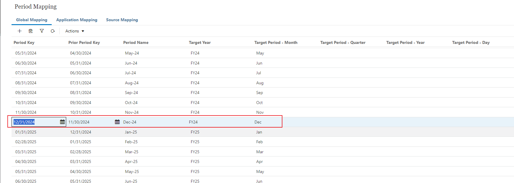

I checked the period mapping in EPBCS data integration and saw the global mapping is enough:

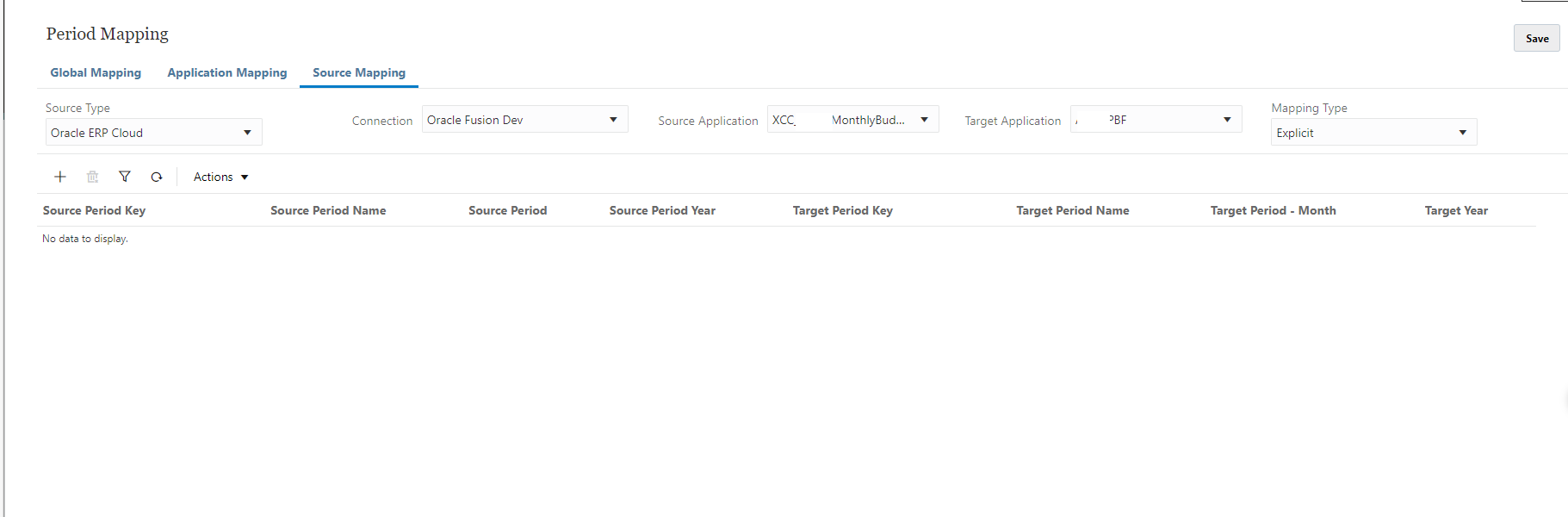

And there is no period mapping for source mapping:

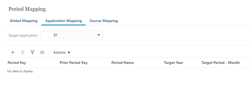

And there is no period mapping for application mapping:
