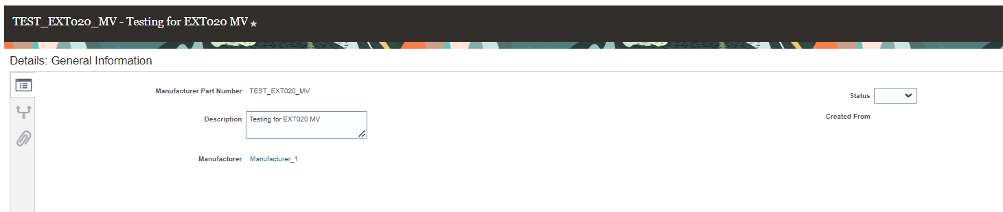

  • TP Item Number Exists in Oracle PD

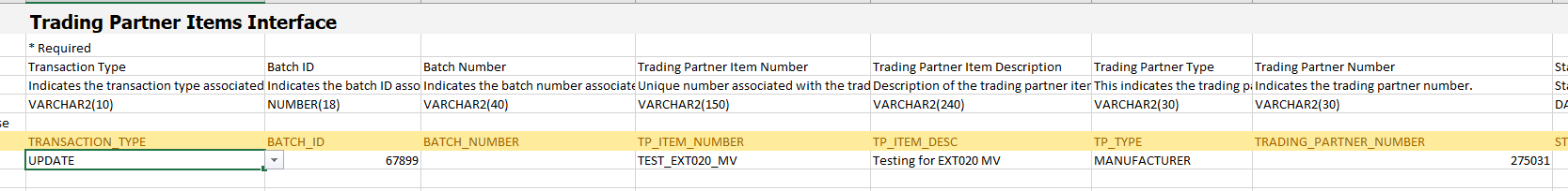

We would like to utilize the Item Import FBDI & the field: 'NEW_TP_ITEM_NUMBER'
Here were our other inputs:

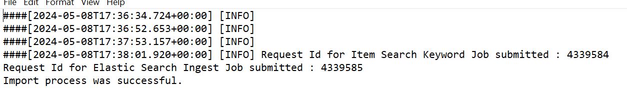

Process ran successfully, but Trading Partner Name was not updated:
Seeking assistance on how to utilize the field 'NEW_TP_ITEM_NUMBER' to update the existing TP Item Number.
