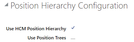

I loaded the Position using HDL, then we load the Position.Hierarchy, because we will use the Position hierarchy to synchronize the Line Manager from the position.
When I'm checking the Graphical Position Hierarchy, there is no node between the parent position in the position detail and the position child
The HCM Position hierarchy is enabled at the Enterprise Level

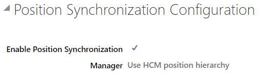

I runned the different ESS Job process below:
  • Synchronize Person Assignments from Position
  • Run HCM Data Loader Postprocessing for Positions
  • Flatten HCM Position Hierarchy
  • Refresh Manager Hierarchy
At all the Legal Entity, there is the Enable Position Synchronization enabled at the "Use Enterprise" level.
