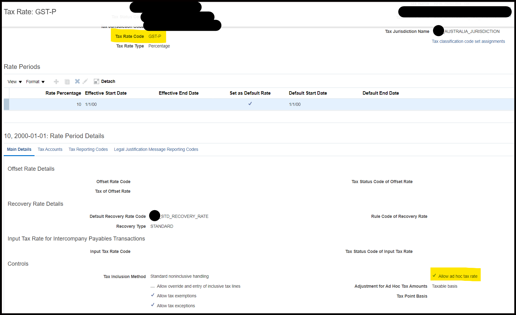

Hi Experts,
For Intercompany transactions between AP-AR, we have a requirement to populate different tax codes in AP & AR. Currently the AR tax code gets copied over to AP. I am currently looking at the link - section - Input Tax Rate Code Association for Payables Intercompany Invoices
I have executed the same setup as well, but I am not seeing the rates getting updated.
For AR I have GST-S & for AP I have GST-P rate codes.
Attaching the setup screen shots.
Can anyone advise what might be missing here. Thanks!
